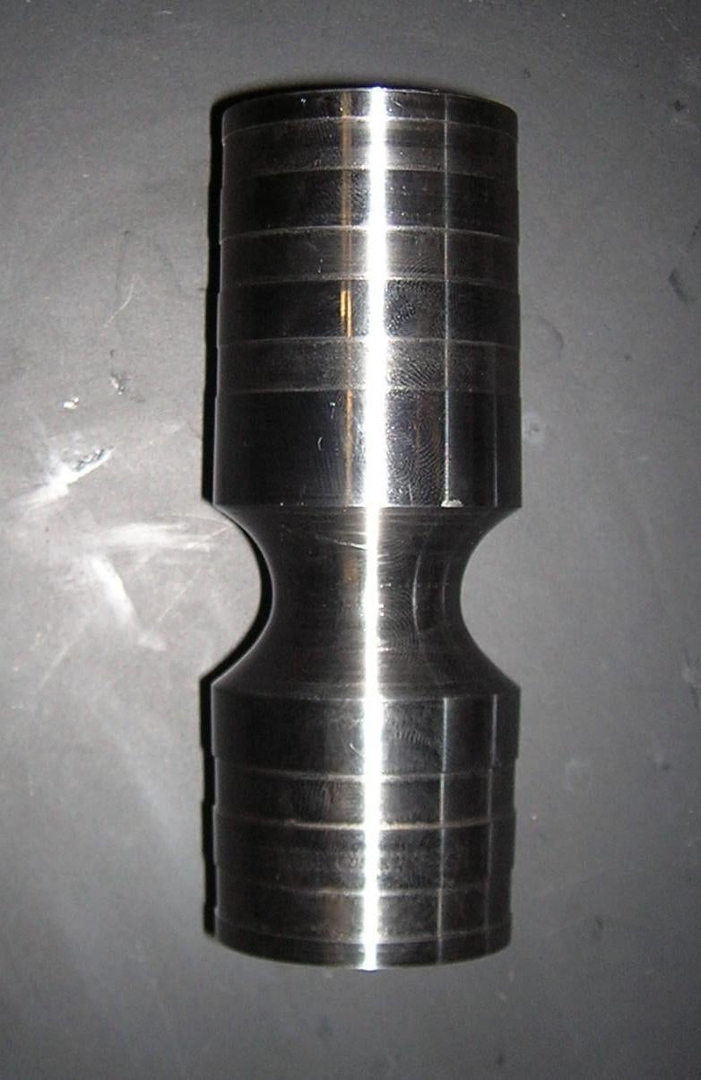

Using 1.5" Dia. stainless steel shaft stock from a marine pump, I lathed out a Jigger/Pony Shot Glass, which is a bartender's measuring glass for shots. Jigger = 1.5oz, and Pony = 1.0 oz. I do not know what kind of steel it is, but I imagine it had to stand up to saltwater, so Im just going to assume its good enough. Its the only stainless steel we had laying around in the shop anyway.
The walls of the shot taper from ~1/32" to 1/16" to lessen the weight and give it a bit of depth. Also, 1/4" wide shallow groves were machined in it as well to make it look nicer. The concave cut in the middle gives your thumb somewhere to hold on to, and it drastically lowers the weight.

-Then use a sharp pointy bit to cut in the shallow grooves to make it kind of fancy. I was originally going to knurl these but since I decided to take so much of the wall off, knurling would have been a bad idea.
The depths of these shallow grooves were just eye-balled, but as you can see in the first picture, not very deep at all. Somewhere between 1/32" - 1/64", probably closer to the latter.
