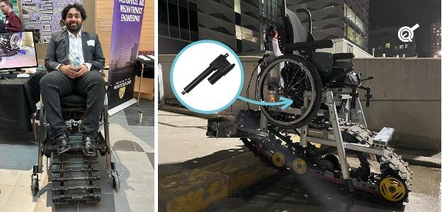

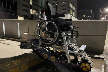

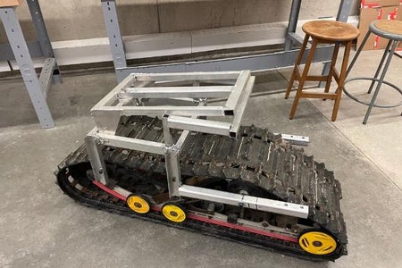

The CMD works as an add-on for traditional wheelchairs, enabling users to handle rough terrain, small bumps, and stairs in winter conditions. It keeps the user safe and comfortable for a full day on a single charge without needing to exit their wheelchair. The device functions allow users to attach and detach it as necessary to overcome outdoor obstacles. This prevents the need to purchase a new wheelchair and helps keep the size and weight to a minimum. The chassis was constructed from square aluminum tubing as a strong but lightweight solution, with extensive force and motion analysis performed to ensure effective design and structural integrity.

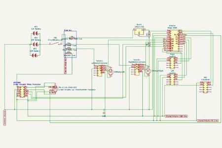

The software that was most used and helpful during the design process was Solidworks for all the mechanical designs and finite element analysis (FEA). For electrical work, a software called RapidHarness helped organize all the electronics and lay out an electrical harness for the building while KiCad was used for all electrical schematics.

Since the CMD will require outdoor suitable ingress protection ratings, heavy duty capabilities, and positional feedback, the PA-17-8-2000-POT Industrial Linear Actuator was found to be the best fit for the application. This model has a brushed DC motor that operates at 12 VDC, includes Potentiometer Feedback, and comes with an 8" stroke rated to handle 2000 lbs of force.
Our BRK-17 Heavy Duty Mounting Bracket allows for secure mounting in the installation process. The actuator is used to tilt the wheelchair seat so that the user can be parallel to the ground when traversing stairs. To do this, a dump truck mechanism as illustrated below was implemented.

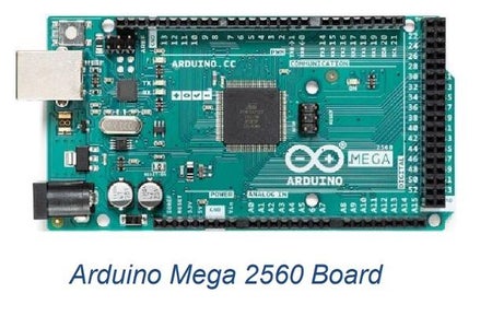

The team originally planned for the STM32 Nucleo board as their microcontroller, however, they ended up using the Arduino Mega 2560 since Arduino support is significantly more available and aligned with the team’s skill set. The software was developed using C programming language to allow users to easily control the device with two analog sticks. This frees the user’s hands to pilot the intuitive steering mechanism, as well as to ensure the user remains safe and balanced during stair climbing using sensor feedback. The sensors were connected to the microcontroller with sufficient current supply and GPIO ports to accommodate them.
Step 7: Electrical System Protection and Fuses
The team’s battery capacity calculations led to choosing a 35Ah, 12V battery from Fortress Scooters, providing more than the necessary power for extended use. Being connected in parallel to each other increased the overall operation time of the device.

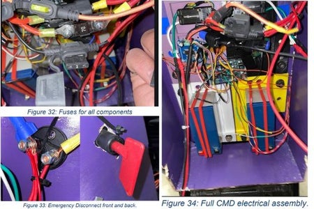

Given that the CMD is high-powered and draws high current from the lead acid batteries, there is a risk of current surges damaging essential electrical components. Therefore, every major electrical component linked to the batteries is first connected to a fuse rated for the correct current value. Additionally, an emergency disconnect switch was installed as a safety feature, allowing the user to immediately stop the current flow to all of the CMD.

The CMD project has not only been a significant learning experience but also a trigger for identifying areas for design enhancements. Time limitations drove some design decisions, while a restricted budget influenced others. Ultimately, the actual amount spent was $2611.44, which is $940.90 less than the initially projected cost for the CMD.
The current CMD prototype is unable to navigate curved stairs. However, with continued development, the next version from Team CMD will address this limitation by incorporating two smaller tracks, enhancing its ability to maneuver stairs and bypass obstacles. For more details on the CMD project, check out the full PDF capstone report and the website link to Team CMD below:
