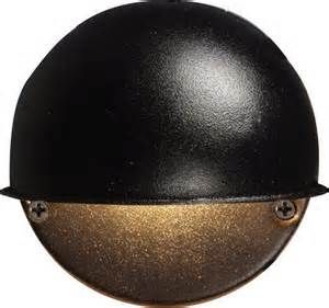

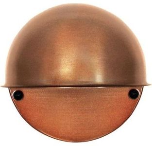

Here are three options I found on the net. I used the copper finished unit on the left. A company named Malibu makes a large assortment of landscape lighting. They are worth looking into and can be found at almost every Home Depot, Lowes, K-Mart, Sears or any home improvement center.

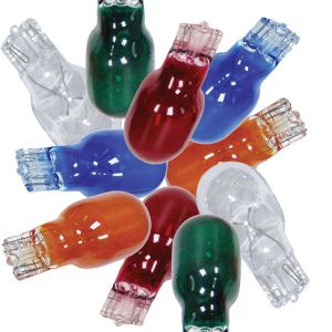

The fixture I used takes 7 watt 12 volt incandescent light bulbs. I prefer the soft orange glow of incandescent lights over the harshness of most LEDs. Some of the wedge base light bulbs are available in 4, 7, 11 and 12 Watt versions.
It is getting more difficult to find incandescent lights since they are being phased out in favor of the more efficient LED version. Incandescent means the light is created from a white-hot wire called a filament. Similar to the first one Thomas Edison made.
You may want to disassemble and paint the light before installation. It is all a matter of personal taste.
