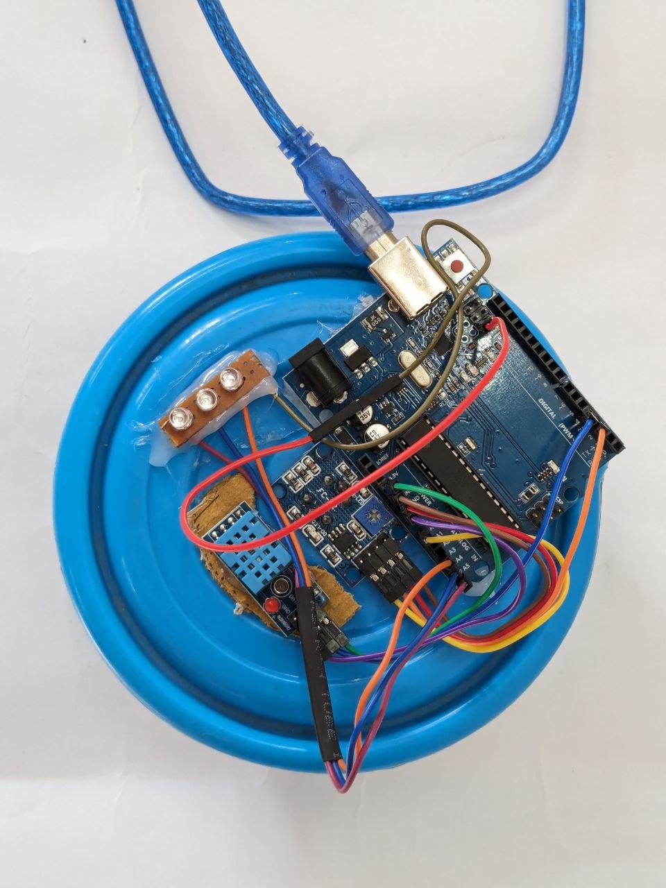

Step 1: Knowing the Principle
As food decays, it releases gases such as ethanol, and methane which are detectable by the MQ3 sensor, and the MQ4 respectively. These sensors translate gas concentration into a corresponding voltage output. This voltage output is then fed to the Arduino's analog pin, utilizing its built-in ADC to convert the analog value into a digital format for further processing. Through these sensors, we are trying to measure the value of Methane concentration in the tiffin box and then determine if the food is safe for consumption. According to some research, it is observed that food articles with methane activity above 250 ppm is not safe for consumption. There are 3 LEDs in this module instead of attaching a display. It is programmed such that if all three LEDs light up the methane concentration in the box is above 250ppm, If two LEDs light up the methane value is more than 170ppm two LEDs will glow, and if the methane value is 150ppm, only one LED will glow. These values were chosen on basis of observations done for weeks.
P.S.:- The LEDs are connected in an unconventional manner due to a soldering error, which is accounted for in the code logic.
Here is a video for its demonstration

Step 2: Connection of Pins
The circuit can be attached to any tiffin box with pins as
- GND: Connected to the GND pins of the MQ-2 and DHT-22 sensors.
- 3.3V: Powers the DHT-22 sensor and all three red LEDs.
- 5V: Powers the MQ-2 sensor.
- A0: Receives the analog output from the MQ-2 sensor.
- D4: Connected to the DATA pin of the DHT-22 sensor.
- A5, A4, A3: Connected to the cathodes of the three red LEDs.
MQ-4 Gas Sensor
- Vcc: Connected to the 5V output on the Arduino UNO.
- GND: Connected to the GND on the Arduino UNO.
- AO: Connected to the A0 pin on the Arduino UNO.
DHT-11 Sensor
- VCC: Connected to the 3.3V output on the Arduino UNO.
- DATA: Connected to the D4 pin on the Arduino UNO.
LED: Two Pin (red)
- Anode: All anodes are connected to the 3.3V output on the Arduino UNO.
Cathode: Each cathode is connected to a separate pin on the Arduino UNO (A5, A4, A3).
Step 3: Writing Code
//I have accidently soldered the positive pole of LED togeather and opposite the normal configuration
// Apologies for the incovinience if you solder them correctly *just replace the LOW with HIGH and HIGH with LOW*
