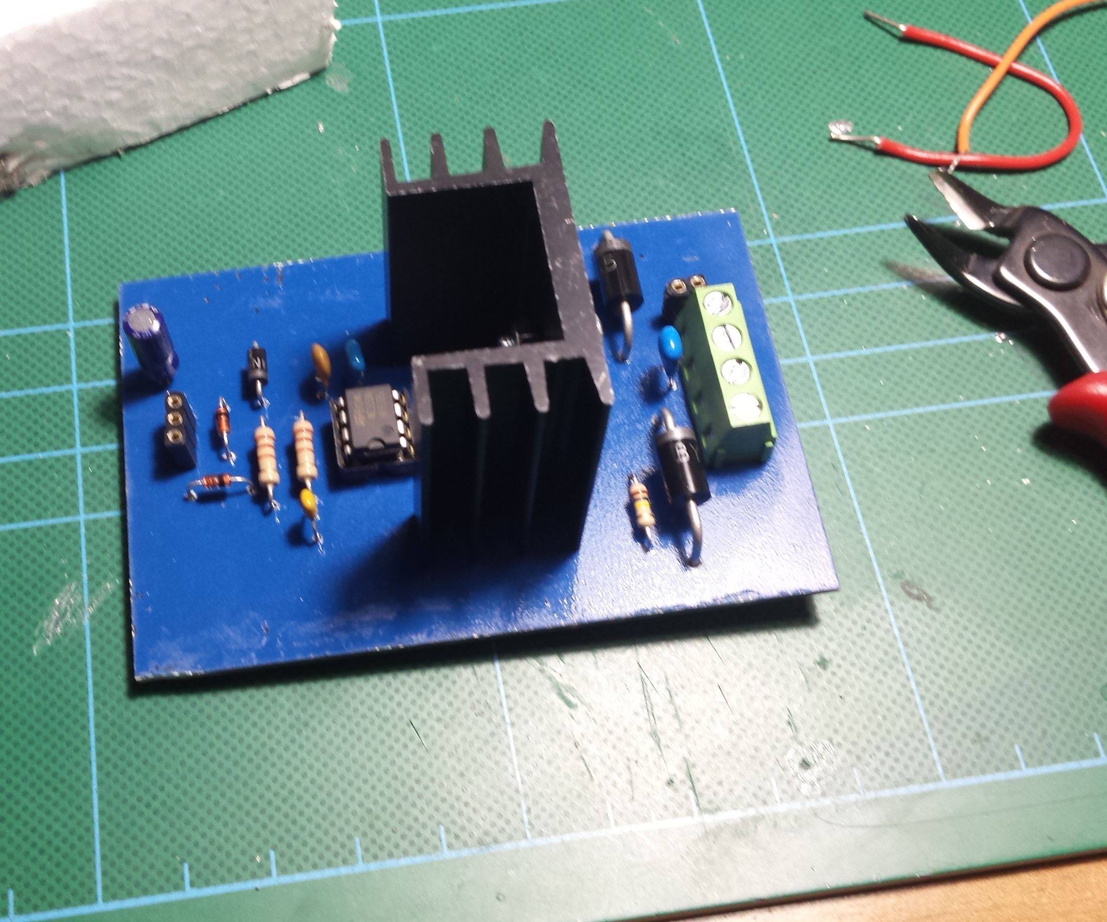

Step 6: Cut & Components
I've cut away the edges and then sand them with sandpaper to smooth the edges.
Then I've started to solder the components onto the circuit, from the lower components to the taller.
Step 7: Finally: Check the Circuit Tracks
Finally, to check if everything was done well, I checked out with the multimeter, set to ohms, all the tracks.
