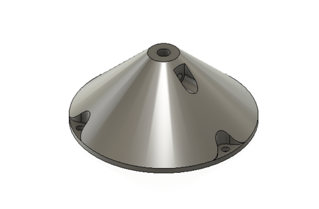

Step 1: Print the Base
Print out the two attached files.
For better quality I turned down the layer height of the uppermost layers (see the 5th picture), so the sphere would come out more rounded. Also make sure to use supports under the dome-part (4th picture).
If your slicer places supports in the screw holes, you need to add support blockers (3rd picture)! Otherwise it's difficult to get the supoort out and you might not be able to screm the screws in.
Also don't worry I'f you don't get out all the supports from the sphere. We're going to fill it up anyway!
