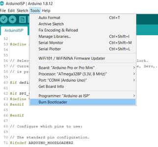

Burning the Bootloader
Once you've done this, you can follow the "Instructions" section on the ISP guide from steps 1 to 5.
Some things to clarify:
- When you are uploading the "Arduino as ISP" sketch, you need ensure you have the correct COM port and processor selected.
- In this case, it means that you've selected the COM port of your Arduino in Tools->Port: COM X (Arduino Uno) and the board is Arduio Uno.
- Select the correct programmer: under Tools->Programmer->Arduino as ISP.
- NOT ArduinoISP or ArduinoISP.org
- Before burning the bootloder, change the board "Pro or Pro Mini" and Processor to "ATMEGA328p (3.3V, 8 MHz)".
- You won't see the processor section until you select the correct board type.
Burn the bootloader onto the standalone Arduino BEFORE you attempt to write sketches on it.

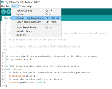

When you upload your sketch, ensure you click Tools -> Upload using programmer OR click Ctrl+Shift+U. You can also hold shift and click the arrow icon, but do not click the arrow icon without holding shift.

- Ensure you've selected the correct COM port and board / processor. When you are burning the bootloader, you MUST ensure you are burning the Pro Mini 3.3V 8 MHz bootloader on it or the fuses won't set correctly.
