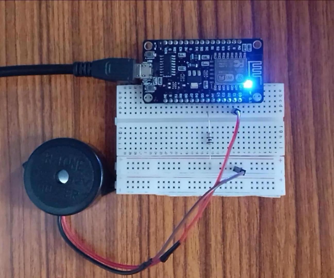

Step 1: The Circuit Assembly
Mount the Board: Insert the ESP8266 module into the breadboard, ensuring it fits properly.
Connect Resistors: Connect the three 220-ohm resistors to pins D0, D2, and D6 on the ESP module.
Connect LEDs: Attach the positive terminal (longer leg) of each LED to the other end of the respective resistors.
◦ First LED connects via resistor to D0.
◦ Second LED connects via resistor to D2.
◦ Third LED connects via resistor to D6.
Common Ground: Short all the negative terminals of the LEDs together. Connect this common negative rail to the GND pin of the ESP module using a jumper wire.
Step 2: Demonstration
