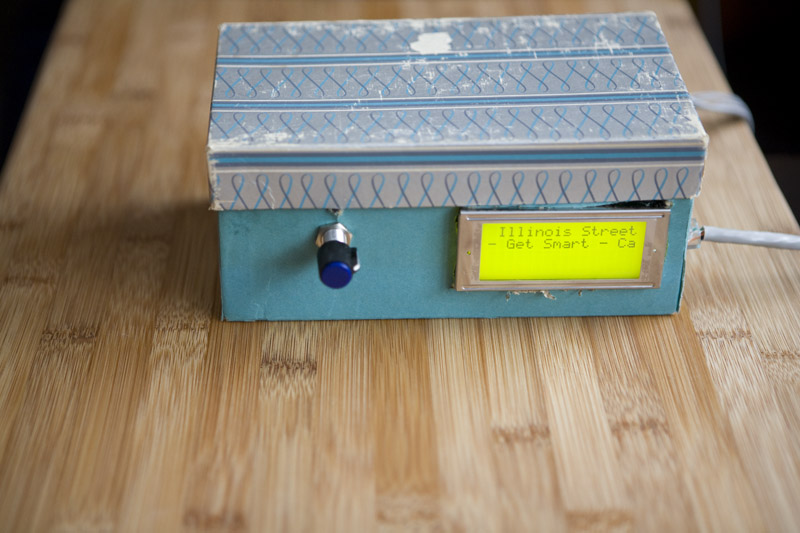

Step 8: Put Into Enclosure
The final step is to cut the holes in the cardboard box and put everything into the enclosure.  As you can see, I was able to position things on the breadboard so that they were up against the sides of the box, and it was a simple matter to cut holes of the proper size.
