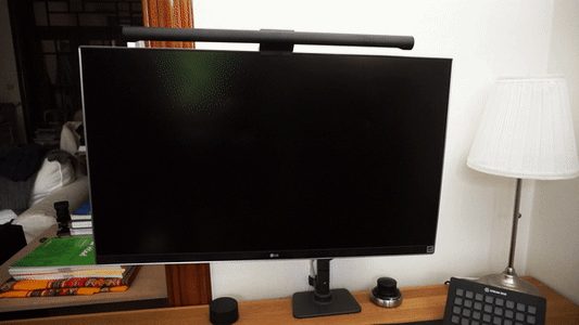

With the transition back to school, I decided to improve my desk setup with an adjustable sit-stand desk frame, to improve the ergonomic situation and make those long evenings working behind the screen a bit more enjoyable. Studying at the Catholic University of Louvain in Belgium, we get a lot of group work to do, so Team calls are quite frequent as well.

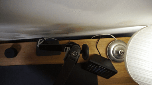

The only problem with that new desk setup is the fact that when my arm-mounted monitor is pushed back, it will grind against the wall when the desk is moving, leaving an ugly streak of paint on the wall.
So I decided to take the time to design a small accessory, that will mount to the monitor arm and hold a rubber rollerblading wheel, to act as a bumper/roller and prevent the monitor arm from coming in contact with the wall.

We can now remove the monitor from the arm and secure our new accessory in place with the grub screw. After popping the rollerblade wheel on the shaft, we can put the monitor back on the arm.
To clean any markings that the unupgraded arm has left on the wall on the wall, a magic sponge can be used.
