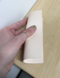

Step 3: Find the Center of the Paper
Very gently fold the paper down the middle both ways to find the center.

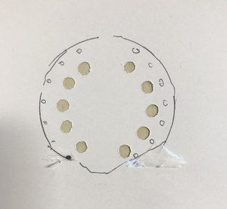

Step 4: Cut Out Holes for the Lights
Trace the circuit playground around the outside. Then, trace each hole. This will give you a rough idea of where the LEDs are. Draw little circles where the LEDs should be, it doesn't have to be perfect.
Next, cut out the holes with a hole puncher or carefully with an X-Acto knife.

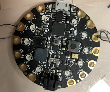

Step 6: Create the Buttons Part 1
Connect the conductive material to the circuit playground. I tied the conductive string to touch A2 and A5.
