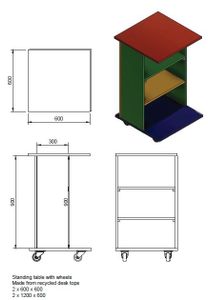

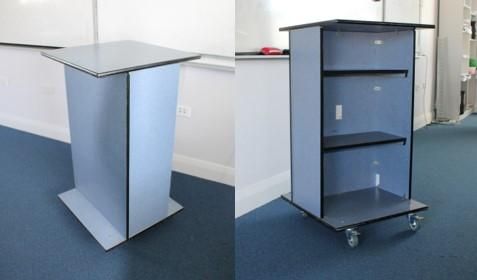

This standing desk is made from recycled desktops and was incredibly satisfying to make. I am not sure which was more satisfying, using recycled materials, making something so useful, or hiding all the cut edges.
Designed for teachers to use in the classroom, it has shelves and a flat top, to stop your mouse from rolling away
This design hides all the cut edges and gives a neat finish

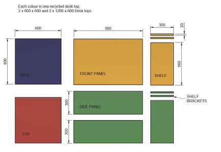

Step 1: Cut Boards to Size
I have colour coded the parts, the same colour parts come from one sheet
Step 2: Assemble Parts
I used small brackets and 16mm screws to assemble the parts
If you think through the assembly you should be able to hide all cut edges

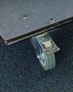

The wheels attach with bolts and lock nuts
On one of the first attempts at this project I used 16mm screws to attach the caster wheels, they broke out after the first obstacle they were pushed over.
