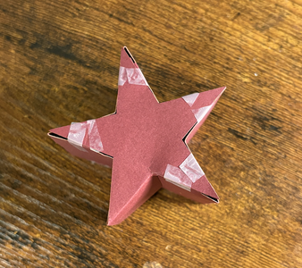

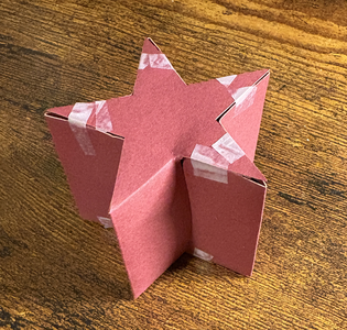

The sketch was printed perfectly into the red cardstock chosen after exporting through Adobe Illustrator. Once taken out of the framed paper, I used a pushpin and ruler to score each line for folding and then folded the sides around the stars and placing the tabs inside the star. I came to an issue with the glue I used for the tabs as it was not drying fast enough and ended up not sticking to the tops, therefore I used tape to fully close the box. In the future I would make sure to use a stronger glue or weight down the triangles more to create a more seamless, clean look without the tape.
Step 5: Finished Box and Whats Been Learned
And now the Star box is complete! Overall, I was very happy with the shape of the box and how each side fit perfectly and all the angles aligned. I would improve how the tabs worked in the design as due to the tape being used it made a messier look of the box and additionally didn't utilize the tabs and therefore added more work than needed to the process. I would look to find a way to make interlocking tabs work while keeping the tops of the box flat. Additionally, I will experiment with adding patterns to the sides of the boxes as seen in the reference picture of the star lantern. Also, due to the paper used the size of the box was limited to fit the 11in cardstock paper as the wrapping design of the box sides were very long. Therefore, experimenting with a different design could allow for less material waste and a bigger sized box. During the process, the most tedious part was creating each shape to ensure the lines were all the same, however once the tools above were figured out it streamlined the process a lot better and will make it easier to design in the future.
