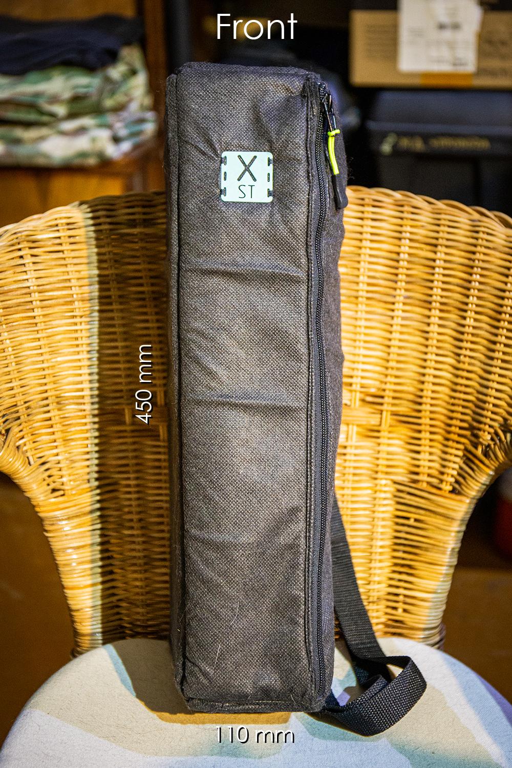

Since this is a precision device, and also contains a number of detachable parts, I decided to make a carrying case for it. The frame of the case is hard, but with soft foam inserts, so that when hitting something, the insides are not damaged.
Unfortunately, I didn't make the patterns, but if you want to make something similar, you can roughly determine from the pictures how and what to stitch. :)

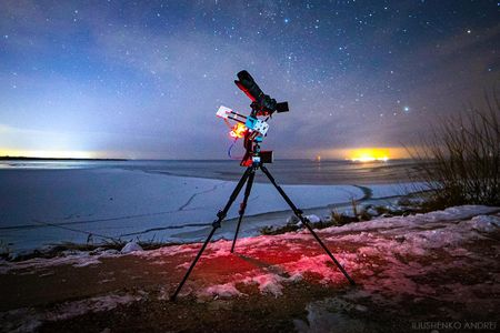

- For the first tests, you do not even need to leave your house. When it's dark outside, install the tracker with the camera by the window so that any remote light source can be seen through the camera lens. Next, you need to focus the camera, turn on the tracker drive and press the shutter button (the camera settings should be something like this, but you may have to experiment: ISO - 100; SS - 5-7 min (in Bulb mode); Apt. - f/20-f/40). The main point of this test is to get a track of a distant light source. This track should be as straight as possible, with as few bends as possible and the same intensity along the entire length. If you see a wriggling line, then something is wrong (perhaps a backlash in the main joint, loose bolts, misalignment of the plane of the large gear and its bearing, etc.).
- Once you've passed the indoor test, it's time to go outside and check the tracker speed. This may require several trips (or several on-site firmware updates if you have a laptop with you). The principle is simple - the tracker with the camera is mounted on a tripod, pointed to the north celestial pole (if you are in the northern hemisphere, or to the south celestial pole, if you are in the southern hemisphere), the camera settings should be: ISO - 1600-3200; SS - 30 sec; Apt. - f/2.8-f/4, camera lens focuses to infinity. Next turn on the tracker, and then press the shutter button on the camera. If the stars are bright dots in the frame, then the speed is set correctly, but if the stars have turned into tracks, then further calibration is required.

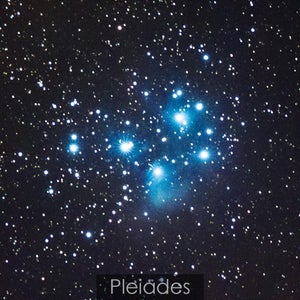

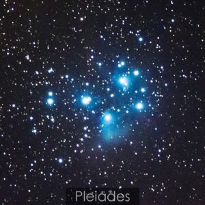

Since the tracker is still in a state of testing, and the weather rarely pleases us with clear skies, unfortunately, I can't show you tons of cool pictures.
At this moment I only have two deepsky test pictures (Orion Nebula (colors are incorrect) and Pleiades), a picture of Moon (taken with Canon 70D + Tamron 16-300) and also several wide-angle shots.
I must say that the tracker is already ideal for wide-angle shooting.
P.S. As I take new pictures with the help of tracker, I will add them here.

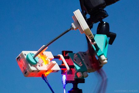

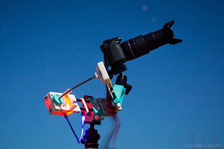

At this moment the device works great together with wide-angle lenses even in the presence of wind, and also works well enough with telephoto lenses in a wind of 1-2 m/s or calm.
However, I also found several flaws:
- Backlash in the rod hinge
- Mismatch between the planes of the main gear and the mounting surface of the gear bearing

- Ограничение: При съемке на длинном конце ветра не должно быть вообще, иначе гарантированно будет шевеленка.
- Ограничение: На данный момент нет смысла использовать фокусное расстояние больше 200 мм (с кропнутой камерой). Будет явная шевеленка из-за люфтов и несовершенства резьбового соединения.
- Ограничение: При съемке на ширики, скорость ветра не должна превышать 1-2 м/с, иначе опять же будет шевеленка.
- Ограничение: На данном этапе нет смысла ставить выдержку больше 4-5 секунд, иначе будет шевеленка из-за люфта в резьбовом соединении.
- Ограничение: Зеленая лазерная указка совершенно бесполезна в холодную погоду, так как происходит смещение спектра из зеленой области в инфракрасную. Никогда не смотрите на лазерный луч и никогда не направляйте его на людей, животных или транспортные средства.
- Механика: Сделаны некоторые изменения главной шестерни и резьбового соединения. Если они хорошо себя покажут, я добавлю новые модели в архив на Thingiverse.
- Совет: Лучше использовать режим вращения главной шестерни против часовой стрелки, чтобы верхняя створка опускалась. Будет меньше энергозатрат для вращения двигателя, двигатель не будет перегреваться, а аккумулятор прослужит дольше.
- Сомнение: На данный момент я не уверен, что работает лучше - металлическая гайка, вклеенная в шестерню, или шестерня, напечатанная сразу с резьбой.
