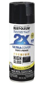

Any work piece you want to look like metal, needs a black glossy layer first. Black gives any metal effect actual depth, which you can not achieve with an underlying white or grey layer.
To prepare your piece, you should slightly roughen it up. I find scotch brite and very useful for that because it goes inte crevices and doesn't really take off material. As a second step I'd use very fine steel wool, which smoothens possible scratches. Important, any scratch in the sutface will stay visible even after 2-3 and sometimes more layers of paint. Prepare your piece in a way that its surface looks like already painted.
Every piece of plastic should be primed first, so the final paint adheres properly. There are paints which do both. One I like to use a lot is called Rust-Oleum prime and paint, black, glossy.
The image shows 2 layers of this applied, ready to get the metal effect on.
