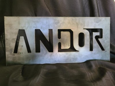

Using the previous drawing I took the back part and hollowed it out to make an inside white space and sized it down to make a square box (image one). I then had to change the letter D in the logo or otherwise the inside part would fall out. I feel my change to the logo still fits the original feel of the logo (image two).

In Adobe Illustrator provided by the school I used the auto line feature to create a "hair line" around the outside of the logo and the inside of the letters. The black line tells the plasma cutter where to cut the metal. Then finally I sent the files off to cut.

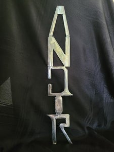

From the cutouts of the big sign I welded them to the small sign attacking them vertically rather than horizontal. To finish up the small sign I angle grinded down the whole face to give it a shiny surface.
