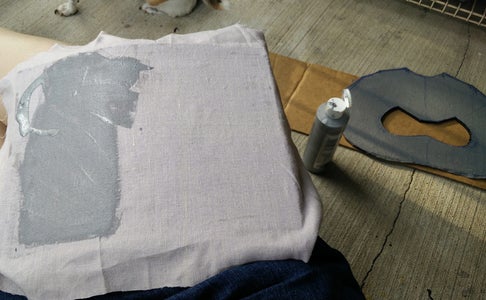

Prepping:
- I cut 2 sheets of fabric that fit a little over the foam sheets.
- Laid down a permanent glue on the foam, enough to squidgy a thin consistent layer. I used, specifically, a permanent fabric glue, to the adhere the fabric to. It need to be permanent so that your sweat of any other water like substance lift he fabric from the foam.
- Lay the fabric on the foam with the glue, press and let it rest and set for at least 24 hours.
- Trace out the mask are, both the main and second eye area, with a pen or something that you can see. I used a sharpie.
- Cut out both mask parts with very sharp scissors. However if you need to you wait until after the first layer sets before cutting out, that works too. The surface will be crispy and stiff. may help.

First layer
- Paint a semi generous layer of silver acrylic. Just enough to get it wet. Once it drys completely, 24 hours later, you will have let it set and seal the foam and fabric.
