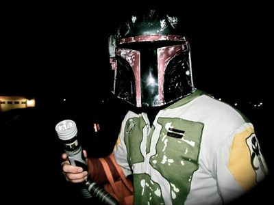

Step 8: Painting and Weathering
Now that you have your clean up casts, go outside and paint them!
Basic Spray painting skills are required in this step.
I painted one with the original boba fett colors for my best friend who loves Boba Fett (Green, Red, Black) so he got a boba fett helmet ^-^
My other amigo likes Blue and red so I painted his helmet Metallic blue, with red accents. I added a stripe down the middle because I though it would look cool, and I also painted some parts black. (Appears to represent the British flag)
The last one was for my dear sister in law and man does she love pink! So I decided "Why not! I'll give her a pink helmet!" This one was painted flat pink along with white/black accents. The whole piece was later sprayed with clear gloss paint to give it a shine.
Now that they were painted, they looked way too new, so I took my dishwashing sponge and sprayed a metalic silver paint onto the tip of the rough sponge.
I dashed the helmets with the sponge and it created a metallic scratch to helmets, making them appear as if they have been in battle.
I was ultimately pleased with the results.
