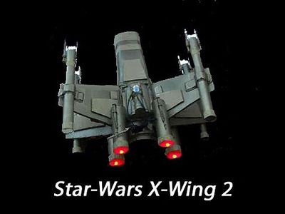

The fighter has a total of 26 LEDs(As I added 1 more LED in each shooter to increase the brightness) 5 in each of the shooters so 16 in total and 4 for the boosters and 1 for the detection unit and one for the headlight, and it had 1 Servo with the detection unit LED on top of it.(It was a blue LED).I recently added a distance sensor on top of the servo and the LED was attached on top of the distance sensor, and it the distance sensor detects something coming close then the LED will scan the area and another LED right beside the scanner LED will blink(shoot).You can also add an infrared transmitter on top of the distance sensor and as soon as it senses an infrared receiver as there will be an LED right beside the infrared receiver, as soon as the light sensor detects the LED the infrared transmitter transmitted data to the infrared receiver and the opponent loses.(You can also play this gave with your friend if you have 2 ships).
Confused??
Ok basically a whole lot of electronics are wired up to act as a targeting device to target the infrared transmitter of the other ship and send data to it, to win the game.(Basically like shooting it with the infrared transmitter,
(Its a self targeting device in simple language.)
The making of this isn't really hard if you are making a second model or you are experienced at these kind of stuff. My first one was “kind of” bad, but my second one was a success, I took it to my school for a talent show and I won a certificate for the most creative electrical/craft creation. I was really happy that day and then when I come home I see that there is an LED contest so I quickly decide that I will post this instructable in the contest.

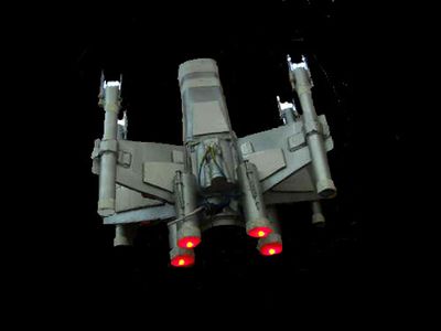

I started off making the base with a deodorant can for the center base and 4 PVC pipes for the shooters and some bigger PVC pipes for the boosters and some cardboard for the wings, it was a really hard job cutting the PVC into size because all I had was a candle and a knife so I had to heat the knife and cut it because I had no drill press or anything.
And then I gave it the first coat of spray paint, and waited it to dry and then gave it another layer of spray paint. I then added details like the shooters top parts(near the LEDs) and some white spray painted cardboard for more detail on the wings.
Then I carved a block of styrofome in to shape with a lot of effort for the front part of the spaceship and it looked quite nice, but then when I spray painted it the pressure of the spray paint was too high so it made dents all over the thing somewhat similar to asteroids hitting the moon and making all sorts of dents, or somewhat like a shower spray on a handful of shampoo, so I advice you never to spray paint on styrofome.
So then I had to re-sand the styrofome into shape and covered it with some cardboard and then spray painted the cardboard. And by doing this I was finished doing the craft part of this model..
The next step was to insert the electronics inside the model, and I faced another problem at this point as the LEDs would not fit in some areas etc, and the wires were too short for some and the breadboard would not fit into the compartment, so I had to do some more cutting and pasting of cardboard and plastic and then I was able to fit the electrics in.So I strongly recommend that you make all the correct measurements and glue the LEDs in the tube before covering up the tubes etc.

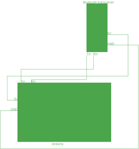

The next step was to program the entire thing.
I used putty on windows as the terminal program(a program that runs the arduino like the arduino's serial monitor)I used it because you do not have to click enter after inputting each and every command.
This was the code I used :

Now I am going to explain what the code does in brief
The first part is adding the servo library to control the servo easily, then it tells which LEDs are connected to which pins on the arduino, then it sets the pins as outputs and in the void loop it basically checks with the computer to see if any key on the keyboard has been pressed, if it has then it checks if the key that was pressed was defined in the code eg : if (val == 9) then it checks if 9 has been pressed, if yes then it performs the action under that part of the code, if not then it just skips that part.
So this is how I control my 22 LEDs and 1 servo.
Just today, I found a laser for 10zl at my local store(3$), and I plopped it open and used the laser instead of the blue LED on top of the servo, and in the dark, it looks really cool.
The electrical parts I used are
If you want to post tweets on twitter do it by using this code in processing(Its a program just like the arduino IDE but for the computer)
When you use that code anything that is written like serial.println in the code will be posted onto twitter.

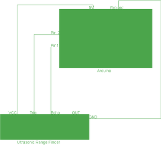

If you want to use the ultrasonic range finder, then use this code and swap the pins and make some adjustments in the code to use it however you want, this is not the code I used, but its an example code from the seller, I did not give you the original code, because I would like you to take on a challenge and write the code for yourself.
int blinkLed=13; // Where the led will blink
int sensorPin=0; // Analog Pin In
int sum=0; // Variable to calculate SUM
int avgrange=50; // Quantity of values to average
int sensorValue; // Value for te average
int i,media,d; // Variables
float cm,inch; // Converted to cm
void setup()
Serial.begin(9600); // To check what is being read on the Serial Port
void loop() {
d=analogRead(sensorPin); // Read the analog value
digitalWrite(blinkLed,HIGH); // Turn on LED
delay(d); // Delay changes with the analogread
digitalWrite(13,LOW); // Turn off LED
delay(d); // Another delay
cm = (d / 2) * 2.4; // Convert the value to centimeters
inch = d/2; // Value in inches
Serial.println(cm); //Print average of all measured values
// This is the code if you want to make an average of the read values
for(i = 0; i < avgrange ; i++) {
sum+=analogRead(sensorPin);
delay(10);
media = sum/avgrange;
Serial.println(media); //Print average of all measured values
sum=0;
media=0;

- An Arduino to USB communication cable ( You can use a blue-tooth transceiver to make it wireless, but I couldn't because I did not have enough space and due to some power problems.
