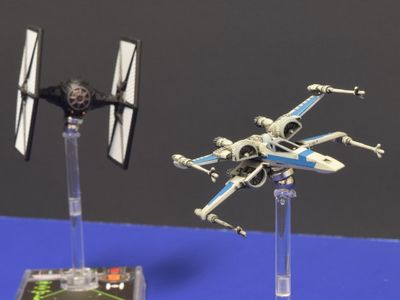

The basic starter set for the game includes one X-Wing and two TIE Fighters. You can acquire more ships and make a larger fleet, but you can also play with the basic set.
As you can see in the picture, the game pieces are rigid, meaning they can't turn, twist, or bank on the stand. The plastic parts are made with a "D" shaped hole, which makes sure that the ship is assembled correctly, facing forward, in one particular direction.

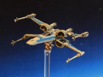

The modification we're about to describe uses a small ring magnet and a steel ball to form kind of a ball-and-socket joint. It replaces the top joint and allows the ship to tilt or move around in different directions. This doesn't affect the game play at all, just looks cool!

In that video, you'll notice that we had a nail sticking into the R421 ring magnet while we were gluing it in place. We used a nail with the point cut off. We found that the glue tends to come up through the hole, which affects how the magnet snaps to the steel ball.
Using the nail in the middle stopped the glue from coming up through the hole, helping the NSB3 steel ball to sit in place nicely.
