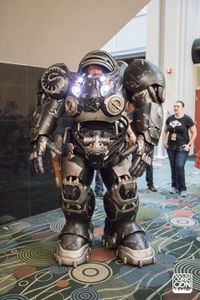

Introduction: Starcraft 2 Jim Raynor Armor
Forming and shaping EVA foam, custom patterns, wiring LEDs, fans and servos, rigging, strapping, sealing, painting, weathering, and bringing all that together for the final product. What started out as a simple design project turned into an ambitious first-time-ever full-on bring-a-character-from-a-video-game-to-life endeavour! Here's how I built Raynor's armor from Starcraft 2 from scratch!
For videos on suit-up, walking around, hand movement and other tests check out my YouTube channel!

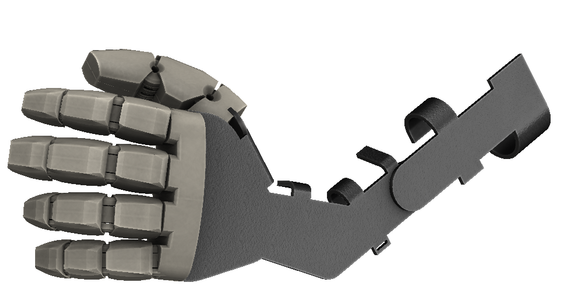

Step 7: Getting a Grip
I wanted to build robotic looking hands for the suit but I wanted them to be functional. After even more research I found a method that uses elastics along the back of a hinged finger and cords along the inside. This allows the user to flex their finger and have the oversized one do the same, but when they relax the elastics take the finger back to straight.
For MkI I designed a frame for each section of finger that would connect together, get strung with the cord and elastic, then coated in expanding foam and carved into shape. Halfway down that path I hit too many obstacles so I returned to the drawing board for a redesign.
For the MkII I decided to build the outer shell and the inner mechanics into one piece. Same elastic/cord theory but the finish work was significantly less. Again I turned to Helpful Coworker and his 3D printer to help me build these. Lots of assembly later and I had a complete set of digits! I mocked up a mounting frame from cardboard to test out the movement, then traced and cut the design onto 1/4" ABS plastic sheet. I added loops to the mount for my palm and wrist and lined them in foam for comfort. They attach to my arm with velcro straps.
Finally, I designed the finger holds, tied everything together and tried them out. Kind of heavy, but they worked just like I'd hoped!
P.S. I'd be happy to share the files, but they required far too much post-printing work in order to get them functional. I was still learning about 3D printers and the tolerances and they don't work without about two weeks worth of drilling and sanding. I'll modify them and get them posted here when I get the chance if there are enough people who could use them!

6 months of design work, 18 months of building, four glue guns, 14 packages of EVA foam, 45 cans of rubber and paint, and of course, blood sweat and tears all add up to the biggest project I've ever taken on.
To clear up a few questions I've had,
It stands about 7ft tall at the tallest point, the shoulders are 56" across, the boots are 23-1/2" long.
The entire thing weighs in at 90lbs, the heaviest piece being the torso, including three battery packs.
I've had some problems with the design of the hands/fingers, so I'm working on a Mk3 version, coming soon!
