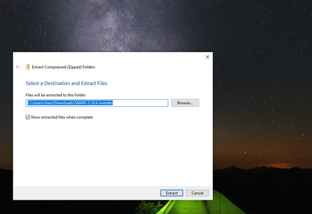

Once located, right-click on it to open a drop box and find the option to "Extract All" and select it; after doing so, a white box should pop up and allow you to "Show extracted files when complete" make sure that box is checked off before hitting extract at the bottom right-hand corner.
Your files should now be extracted, this may take a while but be patient.

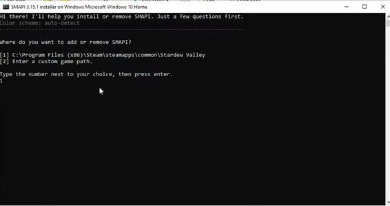

After selection a black pop-up should show. You'll be asked where you want to add or remove SMAPI; on your keyboard select the number 1 and click enter; repeat this same process when asked if you would like to install or uninstall SMAPI, which will confirm installation.

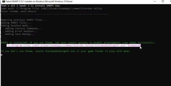

selecting to install SMAPI, a pop-up with green text will show, highlight and copy the entire second line of that green text starting with "C:\Program FIles..".

Step 4: Launch your Steam application and go to where you have Stardew Valley downloaded. After going to options, you will be shown to your general settings; at the bottom of the pop-up, you'll see an area called "launch options" with a blank box under it. Right-click the box and select paste to insert the text that was highlighted in step 3.
