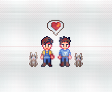

For this project I wanted to make a portrait using my partner and I's characters from the game Stardew Valley and of course I had to include our cats. You can use these directions to assemble any image into a cross stitch pattern. Stardew Valley lends itself particularly well to cross stitch due to the game's pixel art style.

At this point we can edit the design. Some of the pixels may not have transferred correctly or may have gotten lost altogether. I recommend looking back and forth between your GIMP image and the editor to make final edits.
  1. To edit, choose a color from the palette on the left side
  2. select the Paint tool
  3. Click the pixels you would like change
  4. Use the select tool to draw a box around a group of pixels that you would like to move to make the image more centered
The pattern automatically filled all the white space with cross stitches, when you move things around with the select tool you'll end up with blank spots. Feel free to either fill them back in with the paint tool or remove all the background stitches with erase tool.
