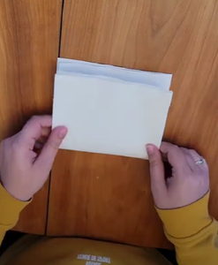

  1. Crease Aida cloth down the middle both ways, making two creases that intersect in the middle of the fabric. This will make it easier to count stitches and figure out where on the fabric to start

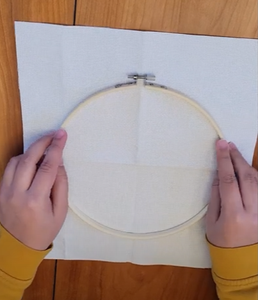

  2. Set the smaller part of the hoop on a flat surface and center the Aida cloth on top of it
  3. Loosen the screen at the top of the larger part of the hoop and press it over the smaller hoop, trapping the Aida fabric between them
  4. Tighten the screw at the top and gently tug the edges of the fabric to ensure that it is snug.

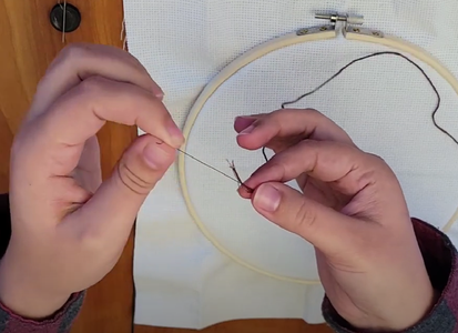

  3. Find the end of the floss and cut a length 12-14 inches long. I like measure it from the tips of my fingers to just past my elbow
  4. Separate one strand of thread from the length of floss that you cut
  5. Fold the single thread in half, aligning the two ends, this will allow you to embroider with two strands at once
  6. Thread the needle
Pro-tip!
I find it easier to thread the needle if you make a small loop of the ends and thread that through the eye of the needle, otherwise you can just use a needle threader too.

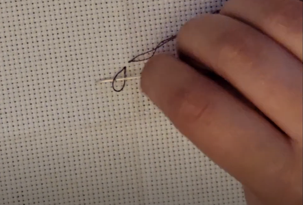

The First Stitch/Anchoring your thread - You will start every new strand of thread of this way
  1. Insert you hook into the bottom left corner of the stitch from the front of the fabric, leaving the little loop of thread at the end sticking out
  2. bring your needle through the back of the fabric in the upper right corner
  3. Insert your needle into the loop and draw it through, pulling the loop closed into a slip knot
  4. To hide the knot, insert your needle back into the hole that it just came out of and pull the slip knot to the back of the fabric
  5. Complete the cross stitch by coming back up through bottom right corner and inserting your needle into the top left corner

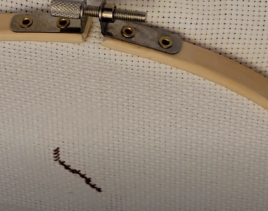

  1. Identify what stitch you'd like to do next (usually an adjacent one) and continue cross stitching. If you want to do a stitch in the same color that's more than a few spaces away, consider cutting thread and starting a new thread in that spot
Be consistent about which direction you make your cross stitches. I always do bottom left corner to top right and then bottom right to top left.
  1. When covering larger spaces with one color or stitching in vertical column, you will want to go up the line making stroke/half of each stitch and then come back down the line doing the other half.
  2. Continue to be consistent about which half of the stitch you do first - left to right and then right to left.

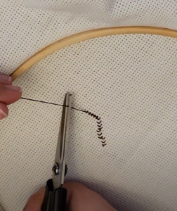

Finishing a piece of thread:
  1. To finish a piece of thread, make sure that your needle is at the back of your work and flip the hoop over so that you're looking at the backs of the stitches
  2. Use the needle to slide the thread under the backs of 3-5 stitches without going through the fabric
  3. This will be adequate to keep your stitches from coming loose
  4. Trim the end of the thread to keep the tail short and avoid getting knotted as you continue stitching
