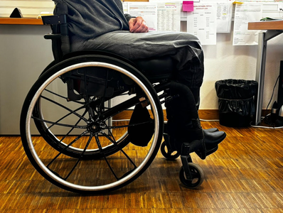

Imagine what you would do if, from one day to the next, you were no longer able to walk and move around freely. Faced with this handicap, many constraints arise, and climbing a slope becomes as hard as climbing a mountain.
In my high school, there was a lady working in the administration who was in a wheelchair. What's more, as part of the Engineering Science specialization, we had to carry out a project using the knowledge and skills acquired during the year. So I came up with the idea of developing a universal system for motorizing all types of wheelchair, without the need for difficult or time-consuming installation. I've called it the Starglider.

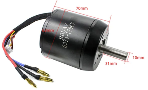

  1. Motor Brushless (6374, 170KV, 2800W, 24V/36V), buy here

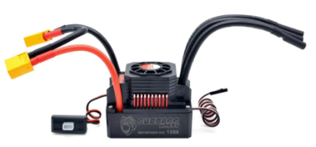

  3. ESC and programmation board, buy here

The first phase consisted in selecting the electronic components. For the electronics, I recommend using a large brushless motor, as this is a motor capable of turning quite fast while maintaining high torque. The motor is powered by a rechargeable lipo battery. To control the Starglider, you'll also need a Seeduino board, an ESC capable of translating the analog signal from a potentiometer into a sinusoidal signal usable by the motor, and a potentiometer.

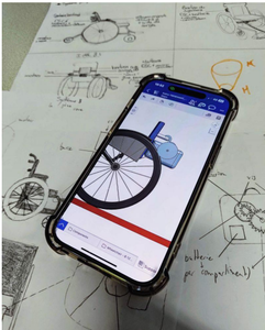

Step 2: Sketchs and Research
Then I started thinking about different ideas for the engine's supporting structure. The challenge was to make a strong, lightweight structure out of PLA, which is a bio-sourced material. 2 main ideas stood out:
  1. create a 3rd wheel that attaches to the wheel axle
  2. create a backpack-like structure, which would attach to the back of the wheelchair on the bar that normally pushes the wheelchair user up slopes.
The first solution had the advantage of guaranteeing optimum stability and thus safety on slopes, by preventing the wheelchair from tipping forward. However, this solution had to be abandoned, as it did not allow the user to turn around in narrower spaces.
I therefore opted for the second solution, which was certainly the best compromise between stability and mobility, while allowing the user to remove and reattach the system quickly and easily at will. This was very useful for my user, for example, as she had to fold and unfold her chair every time she took her car. This solution is universal and adapts to all types of wheelchairs, making the system more versatile and adaptable. Moreover, the components used are standard and easy to find anywhere.
Nevertheless, it might be worthwhile opting for the first solution, depending on the user's constraints.
Step 3: 3D Modeling
To ensure the user's safety and comfort, it's important to consider the wheelchair's balance when the system is in place, and how easy it is for the user to put the system on and take it off.
To attach the system to the wheelchair, we again had 2 solutions to choose from.
  1. a box containing the system, which slides onto an aluminum rail screwed securely to the back of the wheelchair
  2. a hook-shaped structure which attaches to the bar on the back of the chair and is secured by a pin.
But as mentioned, it was crucial that the system could be easily dismantled. For more regular use, I'd still recommend the first solution.

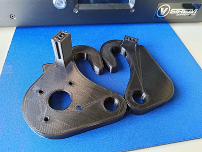

In order to guarantee the system's high resistance and avoid any risk, numerous simulations and optimizations were carried out, until we arrived at the final system. The part resists various types of shock and deformation due to the weight and rotation of the motor. I used, for example, the principle of composite materials, cutting the part into 2 parts and connecting them with a single long metal screw. This will also help you during printing, as it requires no support.
For the link between the motor and the wheelchair wheels, I chose to connect the motor to an aluminum axle using pulleys and belts that can be 3D printed or ordered from the HPC website. The ratio I recommend is ... Rotation is then transmitted by transmission rollers attached to the end of the shaft.

Step 6: Printing
Each part can then be 3D printed without support in PLA. Personally, I bought a belt (RPP5/180/9 on HPCeurope), in order to guarantee a good connection between the 2 belts. However, the strap for the LEGO miniature model has been printed in 95A TPU. So it is also surely possible to do this for the full-size belt.
IMPORTANT : Print "Transmission Roller" twice !

  1. Add inserts in all the holes that will accommodate screws, so that our part is as strong as possible
  2. Attach the largest of the belts to the axle
  3. Assemble the 2 main parts "StarGlider V2 - P1" and "StarGlider V2 - P2" like a puzzle around the aluminum axle and secure this with a 70mm long and 4mm diameter screw, then a nut. We attach the motor to the intended location using the 4 screws supplied with the motor
