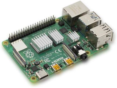

Raspberry Pi
MicroSD Card
HRB8825 Stepper Motor HAT

Step 3: Prepare Raspberry Pi
Install Heatsinks and HAT
Install the heatsinks on the Raspberry Pi and the Stepper Motor HAT.
Install the Stepper Motor HAT onto the Raspberry Pi.

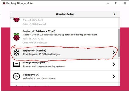

Install Raspberry Pi OS Lite
Using the Raspberry Pi Imager software Install latest 64-bit Rasberry Pi OS Lite on a microSD card. You do not not need full GUI Desktop OS version as this will be running as a Headless Pi. In the Raspberry Pi Imager, scroll down and click Raspberry Pi OS (Other), then select Raspberry Pi OS Lite (64-bit).
Click Edit Settings.
Set your hostname, user/pass, your WiFi info (either home WiFi for testing or Starlink WiFi), Wireless LAN Country to US, Enable SSH.
Click Yes to create the microSD card then put it in your Raspberry Pi and power it on.

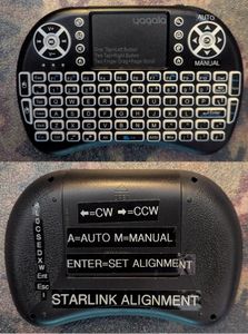

The first time you run this script, it should be in MANUAL mode. At any point, if you hold the Down button or the Left or Right Arrow buttons, it will switch to Manual Mode. If you hold an Arrow button, you will know that it switched to Manual mode when it starts rotating 3* at a time which should be fairly audible even inside the RV.
You can use the Wireless Keyboard to control the Starlink Dish Alignment (use Alignment tab of Starlink App for verification):
MANUAL MODE WIRELESS KEYBOARD COMMANDS
<-- = Rotate 3* CW LEFT
--> = Rotate 3* CCW RIGHT
R = Rotate 1* CCW Right
L = Rotate 1* CW Left
Enter/OK = Set current Sat Heading as Target Heading and update Compass Offset
A = Switch to Auto Compass Mode
S = Switch to Starlink API Mode
Up = Switch to Starlink API Mode (or Auto Mode if API not returning info)
Down = Switch to Manual Mode
0 = Zero Motor
C = Center Motor
I = Initialize Motor (ie,Zero then Center)
E = Enable Motor to keep satellite in position. Uses power and motor gets hot.
D = Disable Motor. May freewheel, but uses less power and keeps motor cool. (better)
W = Try to reconnect to Starlink WiFi
T = Get Raspberry Pi Temperature in *C
X = Turns off Zeroing and Centering Motor and starts in Manual Mode on next Restart of Service
P = Powercycle (ie Reboot) Pi
ESC = Restart StarlinkAutoAlignment Service
DEL = Stops StarlinkAutoAlignment Service (this script) and returns to command line
(Note: you will need to press and hold, P, ESC, and DEL to send those commands to avoid accidently shutting down the service)
