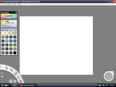

I decided to make a reasonably large document for this project because I wanted to print off the end result. The image size is 2500 x 2000 pixels. That should be large enough for a modest sized digital print.

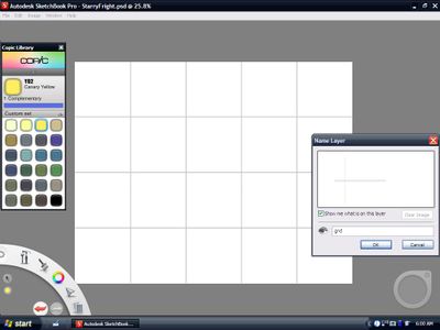

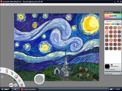

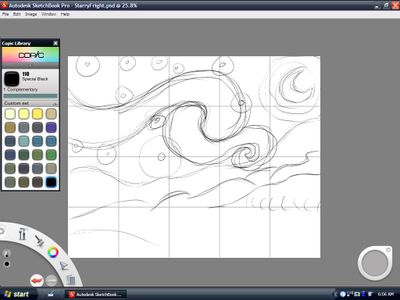

Step 2: Setting Up a Transfer Grid

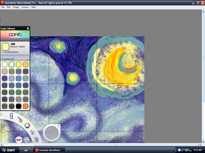

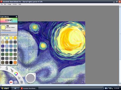

To make things easier to transfer to the new painting I divided both the images up in to grids. I applied a white grid to the original image and saved it out as a jpeg so I could leave it open for reference and I made a black grid for the document I'd be working on. Using a grid allows you to focus on smaller areas at a time and means you can get the basics down and looking correct relatively quickly.
In the Sketchbook document I changed the layer properties to Multiply, renamed the layer "grid" and tried to keep it at the very top of the layers palette as I was working. Any new layers I created were always moved to beneath the grid layer.

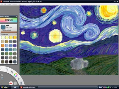

To the left-hand side of the third image you can also see my custom copic colour palette. I went through all the copic colours and picked out hues I thought would match the painting. While the copic colour palette is somewhat limiting compared to using the colour puck, that's not a bad way to start , it keeps you focused and you can always tweak the colours later on.

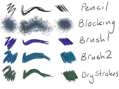

Step 3: Sketchbook Brushes
I spent a couple of days playing around with the Sketchbook brush settings because this is the first time I've used the pro version. I have Sketchbook on my android tablet but I don't get to use it very often. I ended up tweaking a few of the brushes for this project and I've uploaded them for people to download if they'd like to use them.
Starry Fright Brushes for Sketchbook Pro 6
I saved the swatch image out as a jpeg so I could glance at it to remind me which brush was which. I didn't end up using the Dry Strokes brush very much but it goes with the set so I left it in the download.

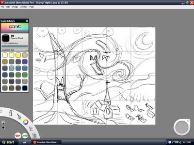

Step 4: Sketching the Background

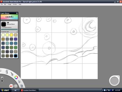

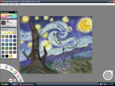

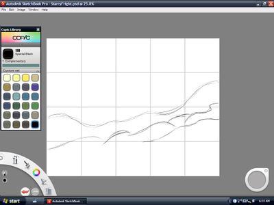

I created a new layer below the grid layer and renamed it "BG Sketch". On this layer I started pencilling in the background features. I started with the rolling hills, moved on to the night sky with the moon and stars and then on to the swirling clouds.
Step 5: Sketching the Details

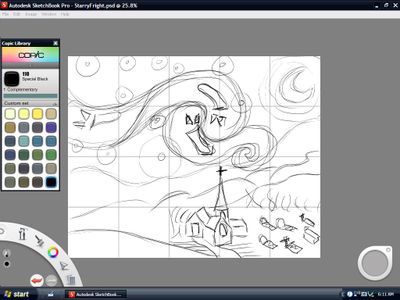

After the background was sketched out I added a new layer and renamed it "FG Sketch". On this layer I pencilled in the smaller details like the church and graveyard and the scary faces for the clouds which became ghosts. I also roughly sketched in a spooky, monster looking tree to replace the cypress found on the original artwork. I wanted to keep the foreground and background sketches on a different layers so that I could turn each layers visibility on or off when I needed to.

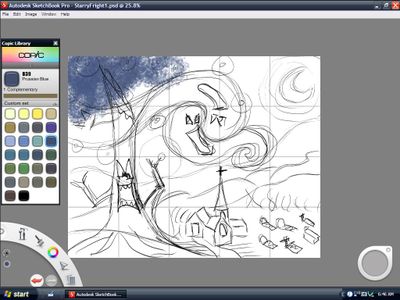

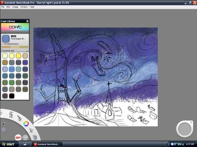

Step 6: Blocking in the Basic Colours
After sketching in the basic details it was time to add some colour. I wasn't too fussed about making it perfect at this stage, I just wanted to block in the basic colours. I created a new layer and renamed it "BG Blocking" and moved it to the bottom of the layers list so that I could see the sketches above it.
I used the VanGogh_Blocking brush I'd tweaked earlier and laid down big blocks of colour. There is a cool feature in some of the brushes in sketchbook pro to vary the colour with every stroke. Most of the brushes I tweaked have this setting activated so that I could get a good range of similar tones using one colour. It feels a lot like using a "dirty" brush in real life.
As with the sketch layers, when it came to blocking in the colours for the tree and the church I created a new layer for it as well and renamed it "FG Blocking".

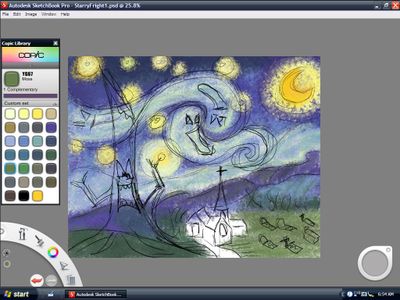

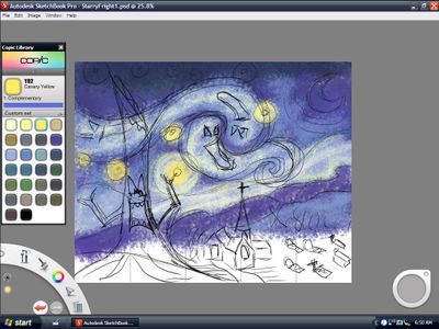

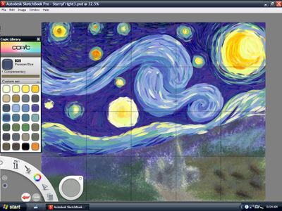

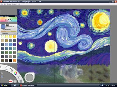

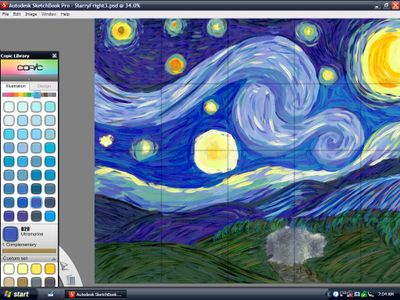

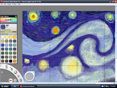

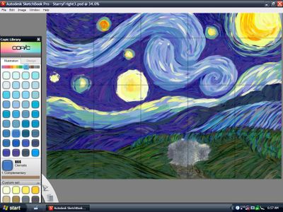

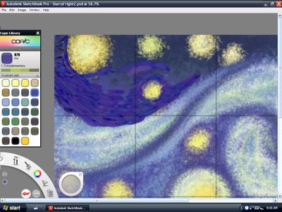

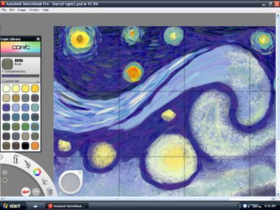

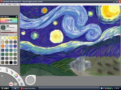

Step 7: Background Brush Strokes
I created a new layer and renamed it "BG Strokes" and moved it to below the sketches and above the blocking layers.
This is the stage where it gets interesting and the image really takes on a life of its own.

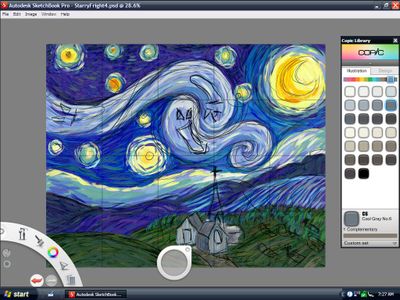

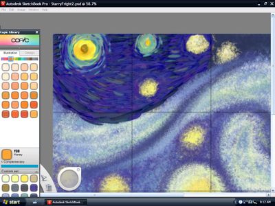

Using the two brushes I tweaked earlier (Brush1 & Brush2) I started laying down small strokes of colour starting at the upper left side of the image. The brushes really do most of the work here. I used short strokes and followed the sketched outlines of the layers above. It started to come together quite nicely after just a few minutes. This stage is time consuming but by no means technically difficult and the pay-off is definitely worth the effort.
I worked my way down, starting with the sky, moon and stars, moving on to the ghostly forms, down to the rolling hills and the green countryside below. I added in some smaller details like the line of trees and the mound in the foreground for the spooky tree- and at the end I decided to tweak the sky colour so there is a slight shift in colours at the very last image.

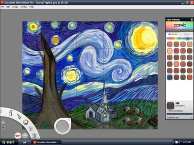

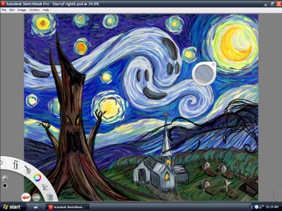

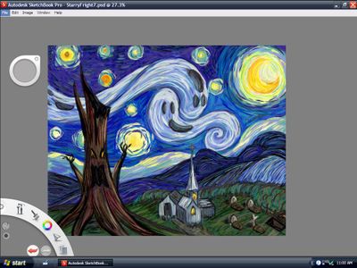

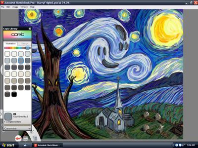

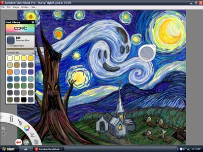

Step 8: Foreground Brush Strokes

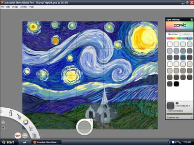

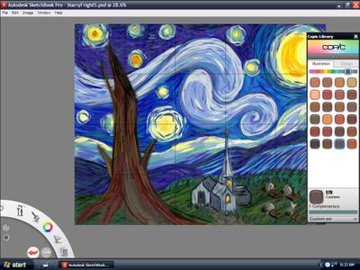

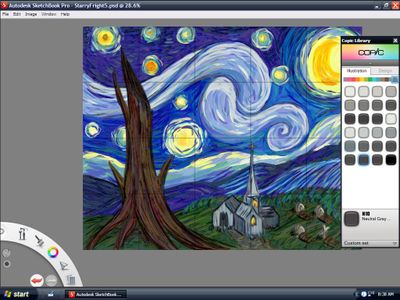

With the background strokes completed I created a new layer for the smaller, foreground details such as the church and graveyard and the creepy tree. I moved this layer to sit above the BG stroke in the layers list.
Using the sketch layers as a guide I started filling in the church with small strokes. After the basic shape was down I turned off the sketch layer visibility and refined some of the details. I made a couple of the church windows glow and added a cross to the church steeple. I moved across to the graveyard area and painted in some tombstones and mounds of earth and I added a freshly dug grave as well.
I turned on the "FG Blocking" layer temporarily to get an idea of where to paint the creepy tree. At this point I stopped used my custom copic colour palette and instead switched over to the full range of copic colours. I filled in the tree shape with a range of browns and warm greys and then painted in a dark hollow on the trunk to look like a spooky face. I made the eyes glow with a smidgen of yellow and added some grabbing branches for hands.
After the tree was done I gave the cloudy swirls some classic ghost expressions to make them stand out more and I tweaked some of the colours to make them more ghost like.

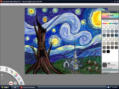

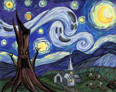

Step 9: Refining the Hills
When I look at the original image by van Gogh, one thing that strikes me is that even the hills look to be sleeping. I wanted to make that a bit more obvious for this Halloween remake so I ended up redrawing the hills to look like a sleeping form.
I added a new layer to tweak the hills and moved it to sit between the FG Strokes and BG Strokes layers. I wanted it to sit below the FG Strokes layer so that the church and graveyard wouldn't have to be repainted.
I sketched in a female form with her head tilted towards us and gave her some flowing hills for hair. I painted over the top of the sketch in similar hues to the existing hillside.
