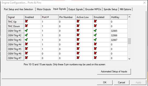

Step 3: Setup Mach3 Ports and Pins
Go into mach3 under config, ports and pins
Select the input pins tab
Scroll down to OEM Trig Number 1
Enable the pin, check emulation and click on the Shortcut box. A box will pop up asking you to press the key you want to assign
press the Ctrl-NumPadKey and the desired numpad key to assign the key to the shortcut

In this I found Start = 1001 , Pause = 1002 and Stop = 1003
In Mach3 under Config, System Hotkeys go to the right hand side in the external buttons OEM codes enter the matching codes
If all went as planned, your buttons should work as desired
