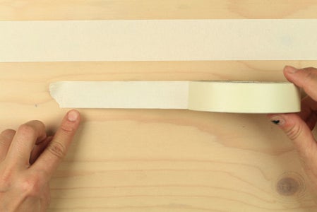

You can apply Electric Paint directly to most materials but if you chose to make a temporary sensor you can use masking tape as a substrate.
Attach the tape to a low-tac backing such as plastic, and cut to the length you require for your sensor surface.
Apply paint generously from the Electric Paint 10ml Jar using a paintbrush and leave until completely dry.
