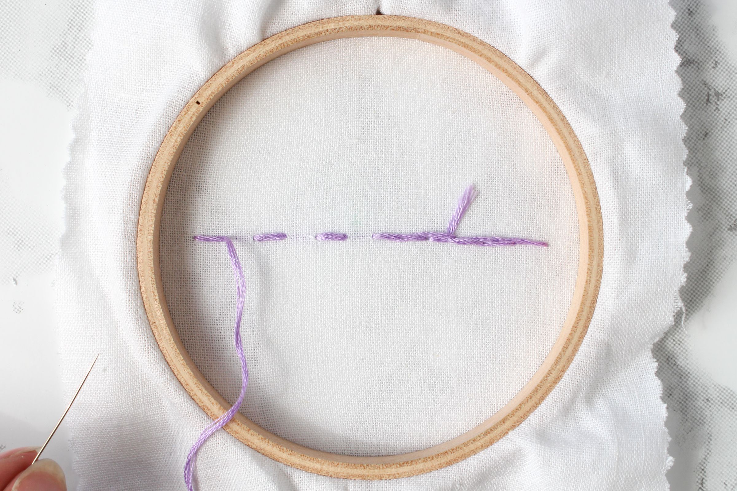

Everyone has a favorite method for securing their floss. I personally like to use knots, just because it's the way I was taught. I know it's a method that works, so I stick to it.
There are other methods, though!
The first way to avoid knots is done by weaving in the ends of your floss. The second way to avoid a knot is to use a "waste" knot, which you'll cut away when you're done with that piece of floss. Any time you use a waste knot, you'll need to finish the end of your floss by weaving it in or knotting.

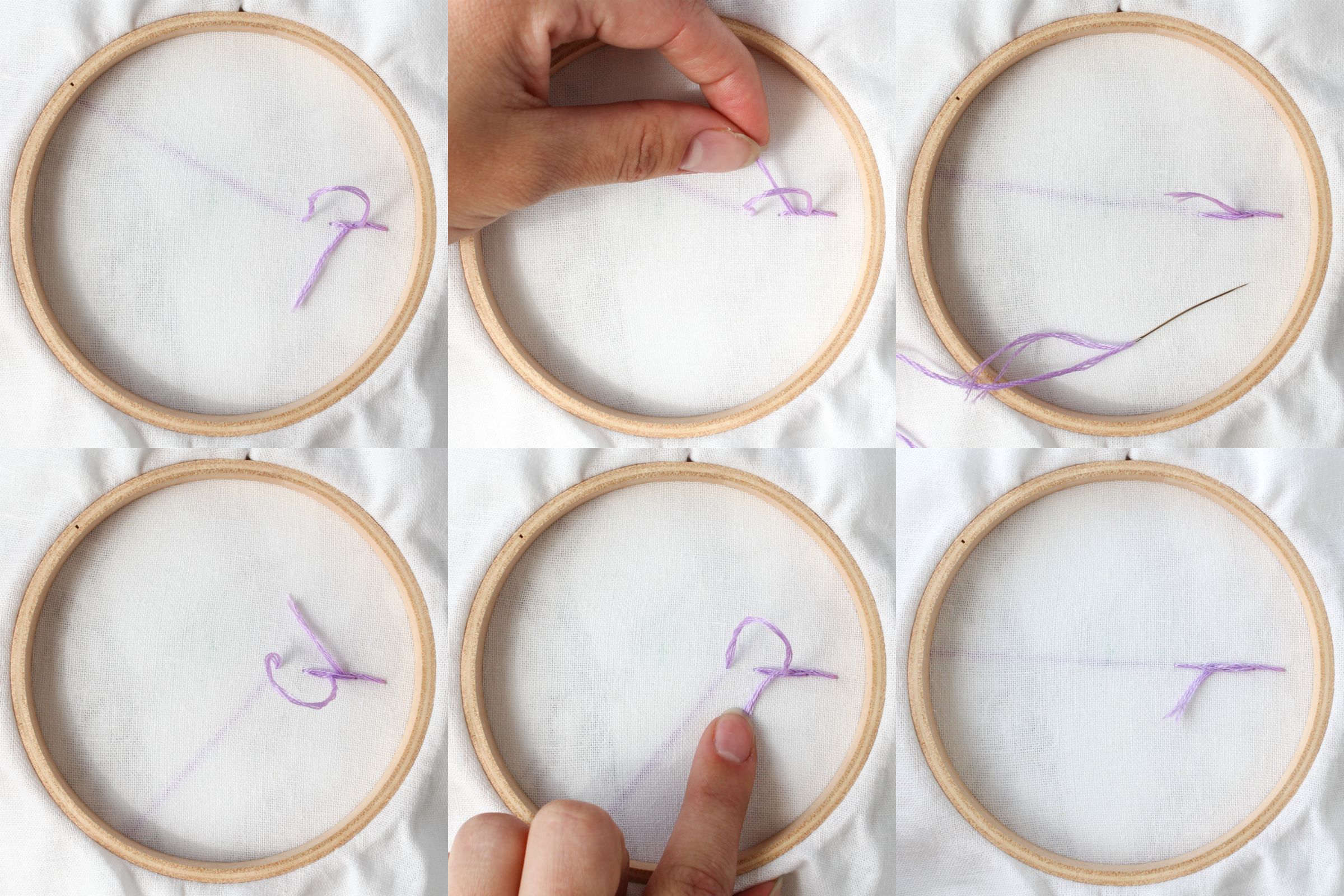

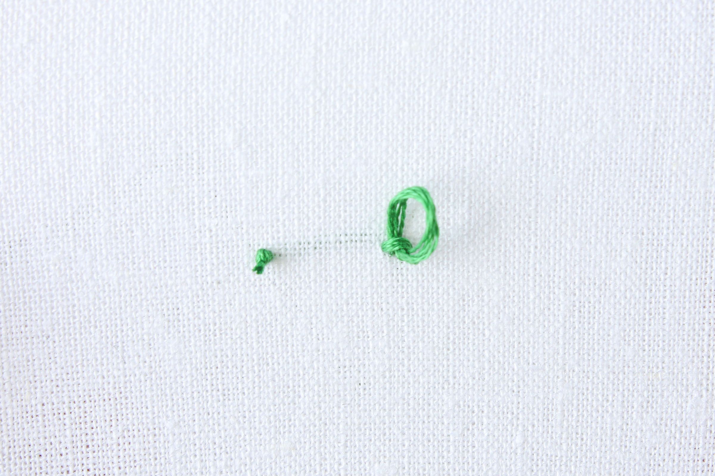

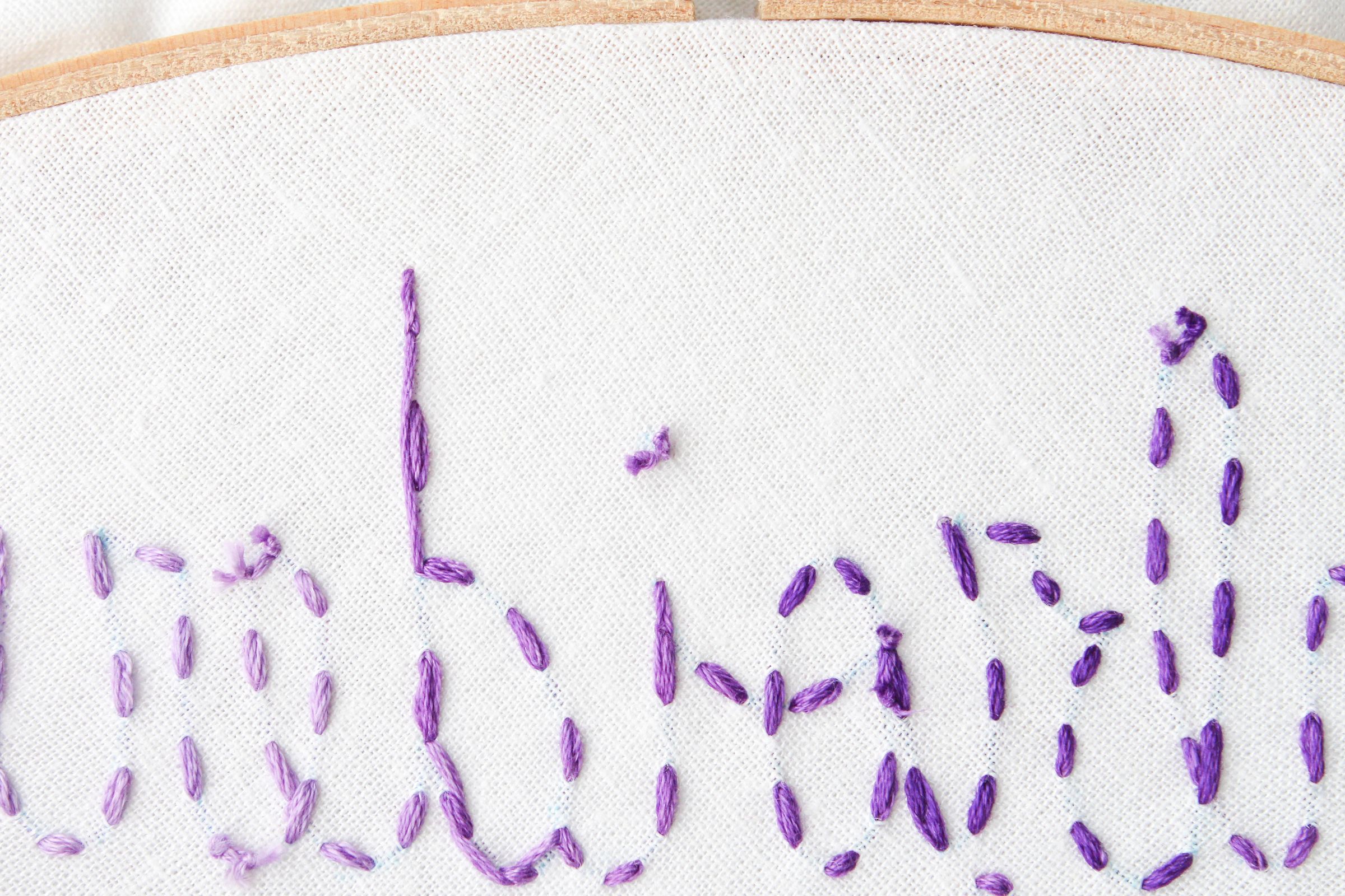

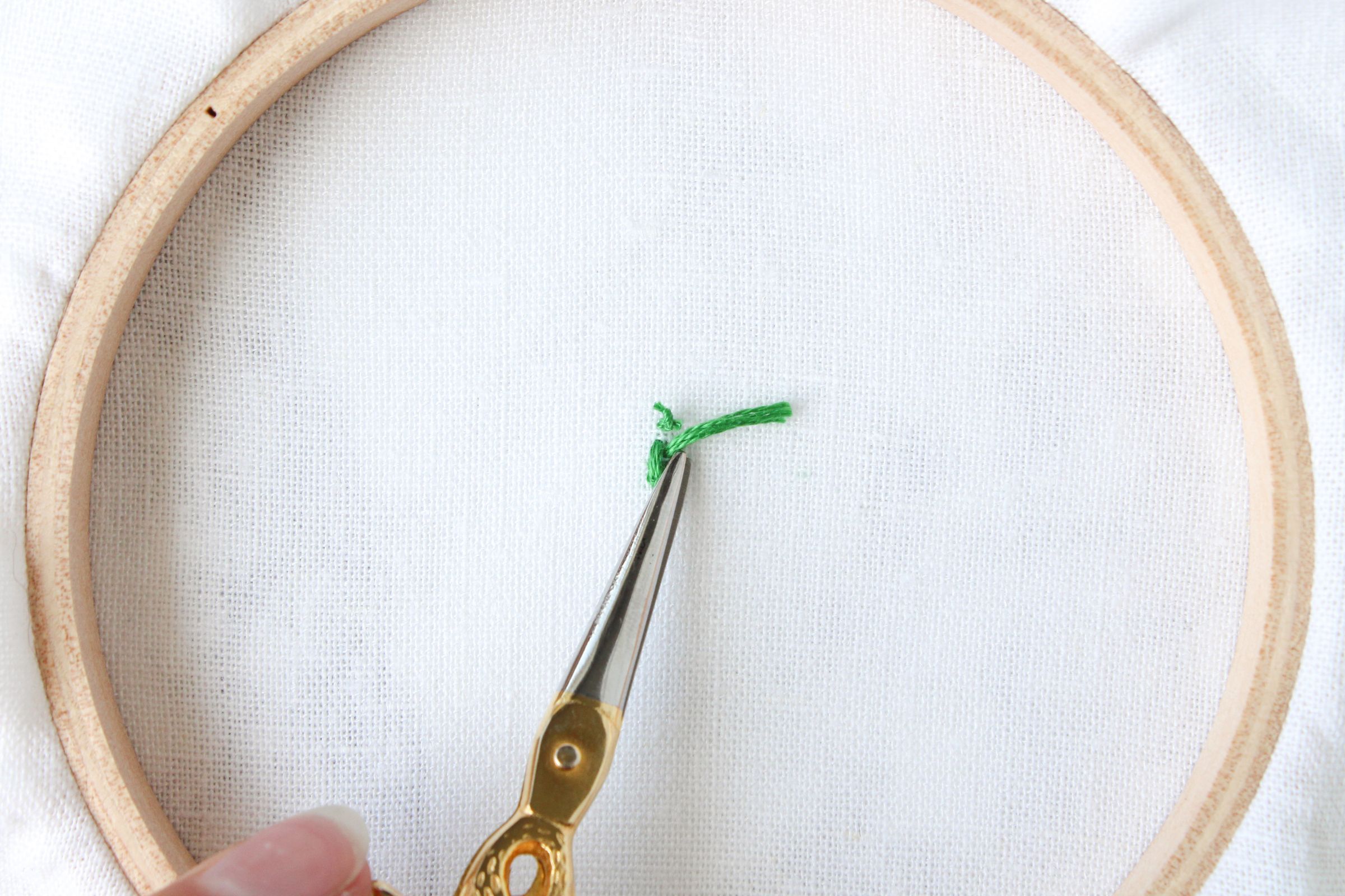

To begin with a knot simply knot the end of the floss! If I'm using 2 strands, I'll often knot twice just so it's less likely to pull through the fabric.

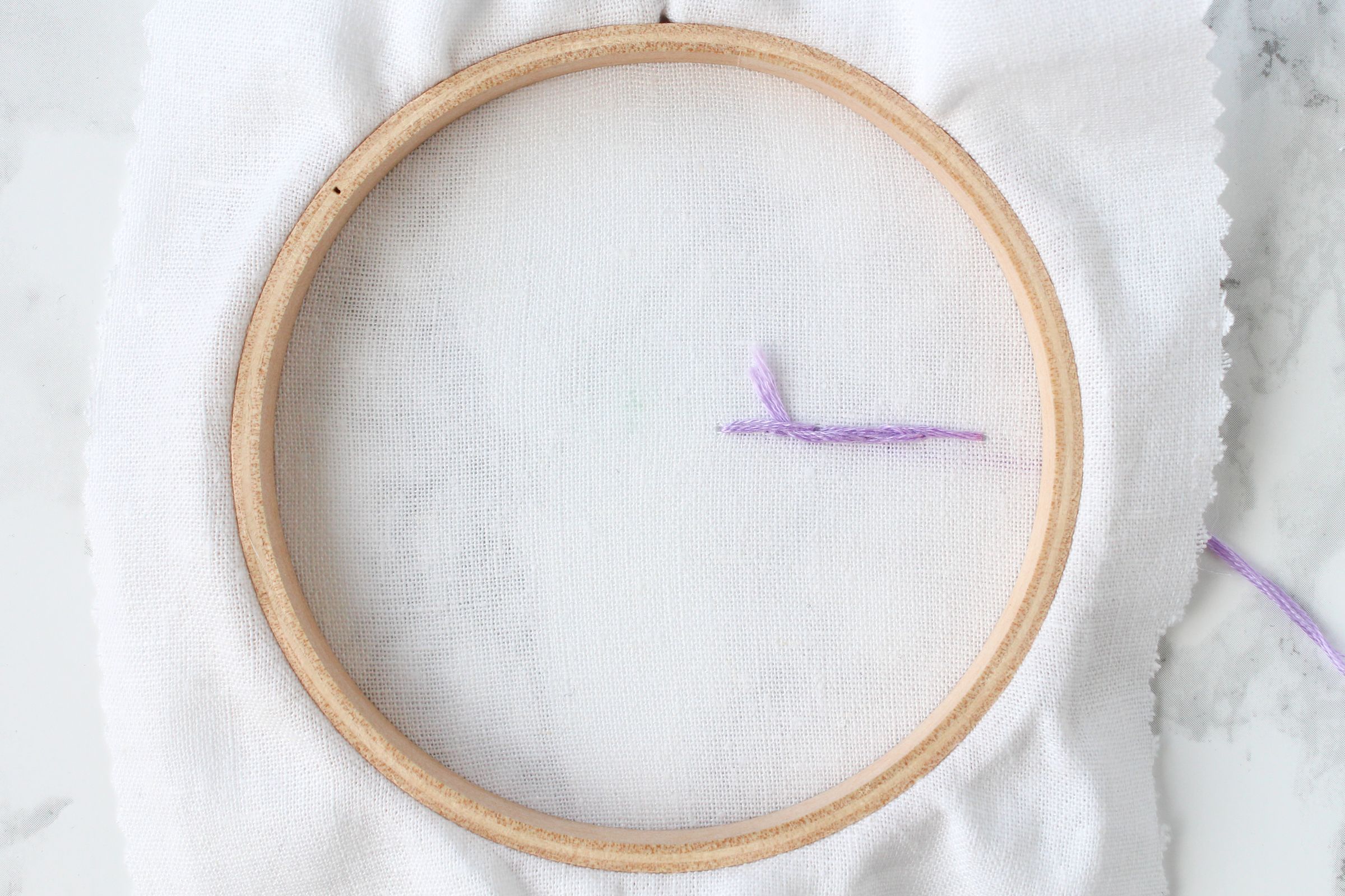

Ending with a knot when embroidering is incredibly easy since you have multiple strands to tie together.
Tie a standard knot at the end of your floss. You don't need anything fancy here.

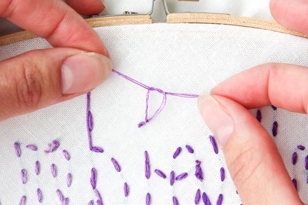

To tie off a piece of floss, simply divide the strands in half and tie them together.
Cut the strands close to the knot and you're done!

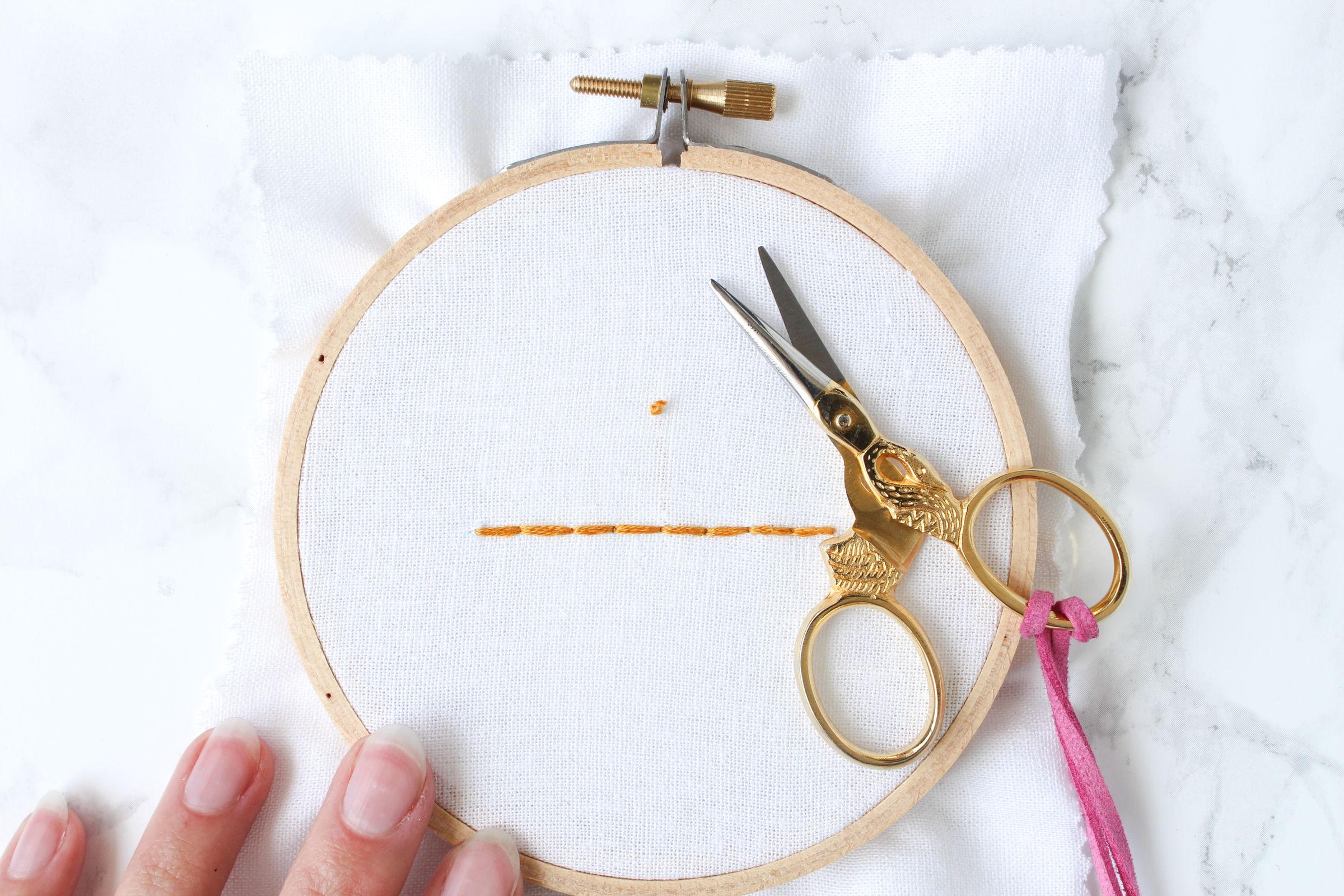

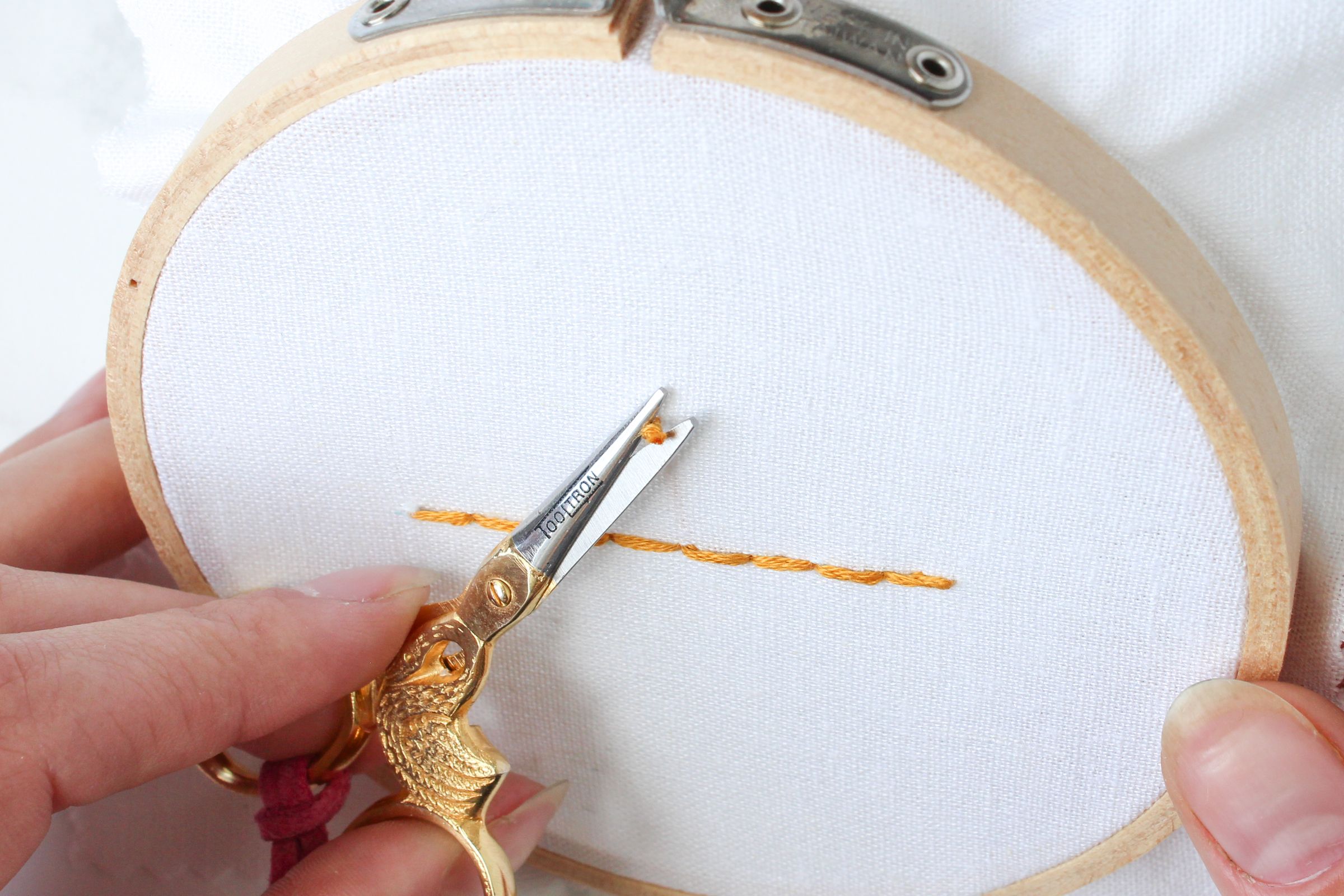

Step 2: Starting by Using Waste Knots on Lines of Stitching

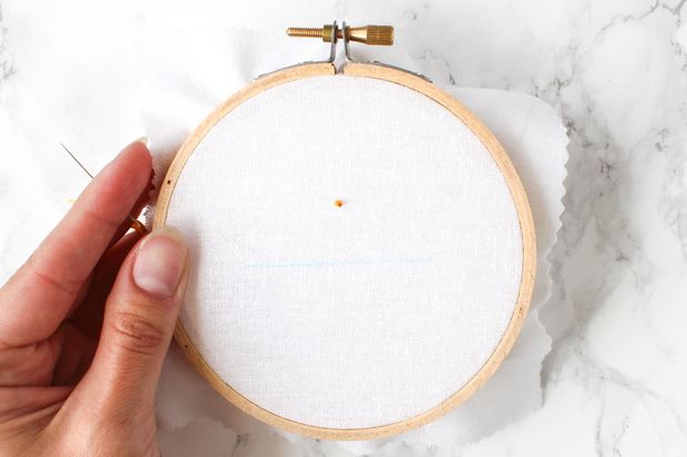

A waste knot is essentially a knot that will sit on the top of your fabric while you stitch. You'll cut it away once you secure your floss with a few stitches.
This is the most secure method of starting your floss without a knot, and also the least visible way.

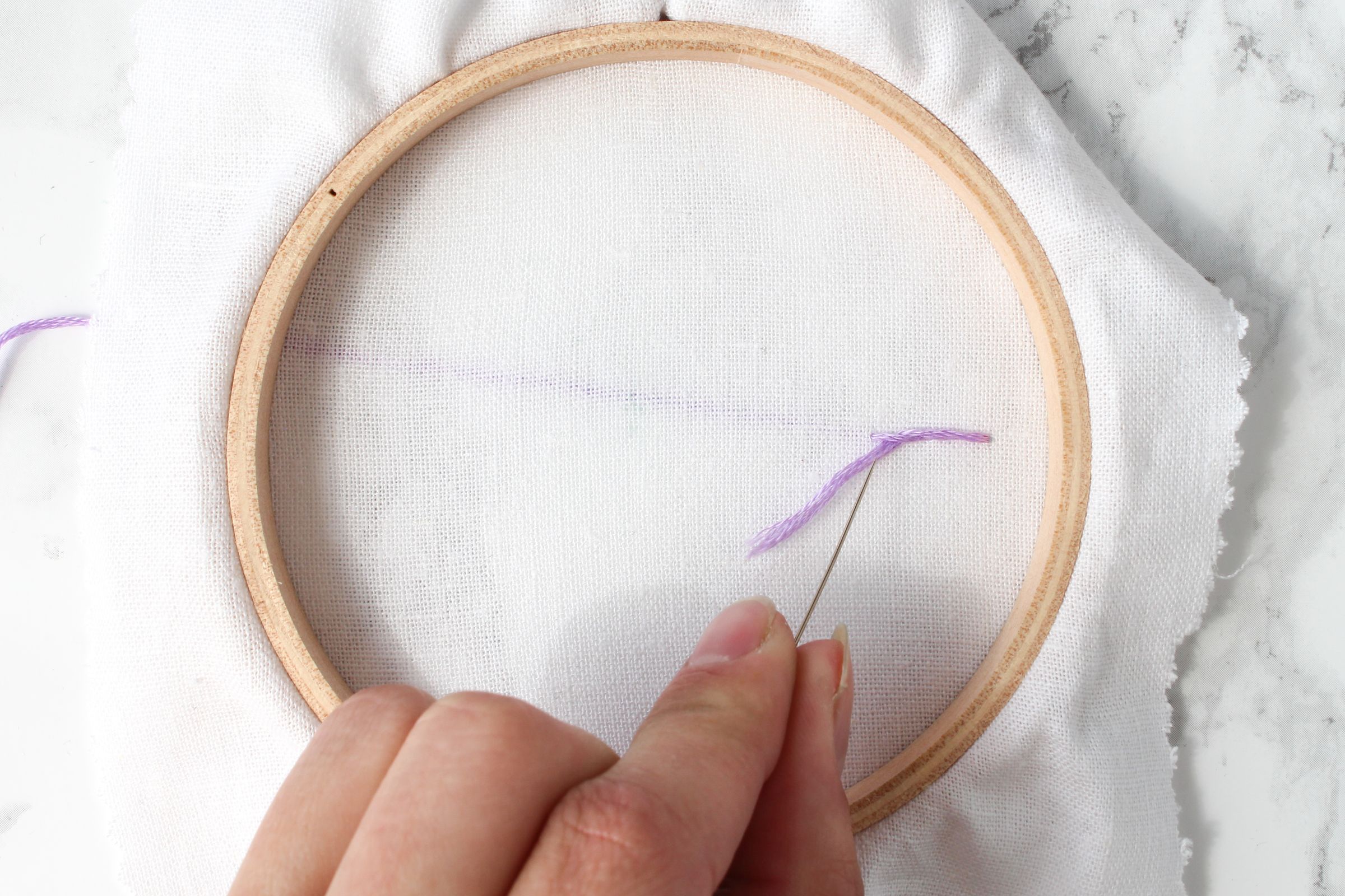

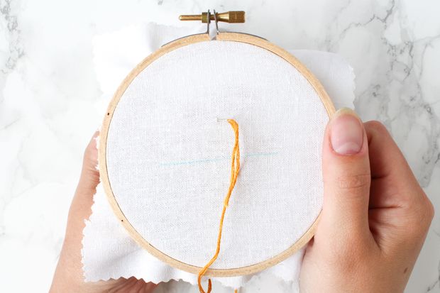

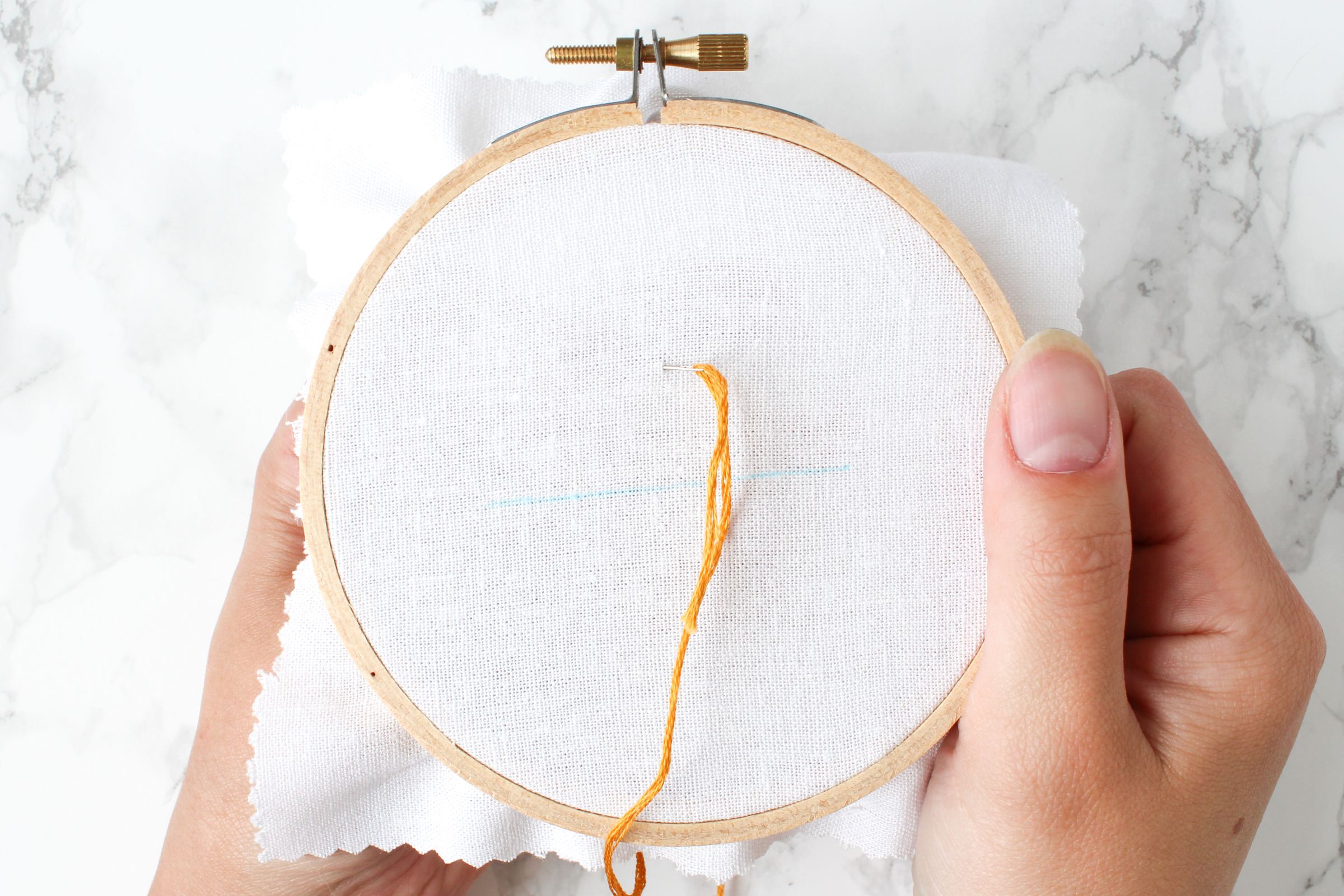

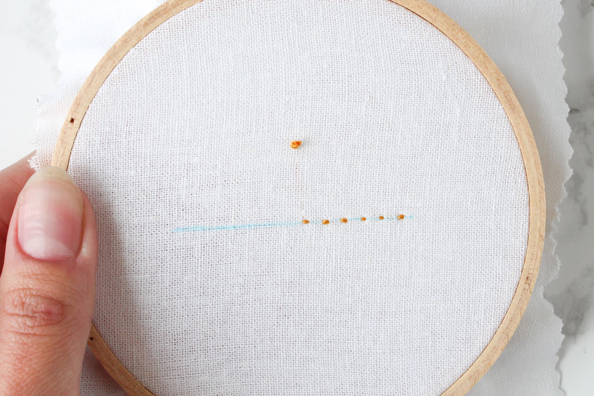

First, you want to put the needle through the fabric from front to back about an inch away from where you plan to start. You can place the knot on your stitching line or to the side - I prefer to put it to the side so I can keep stitching and worry about it at the end. Pull the floss through until the knot sits against the fabric.

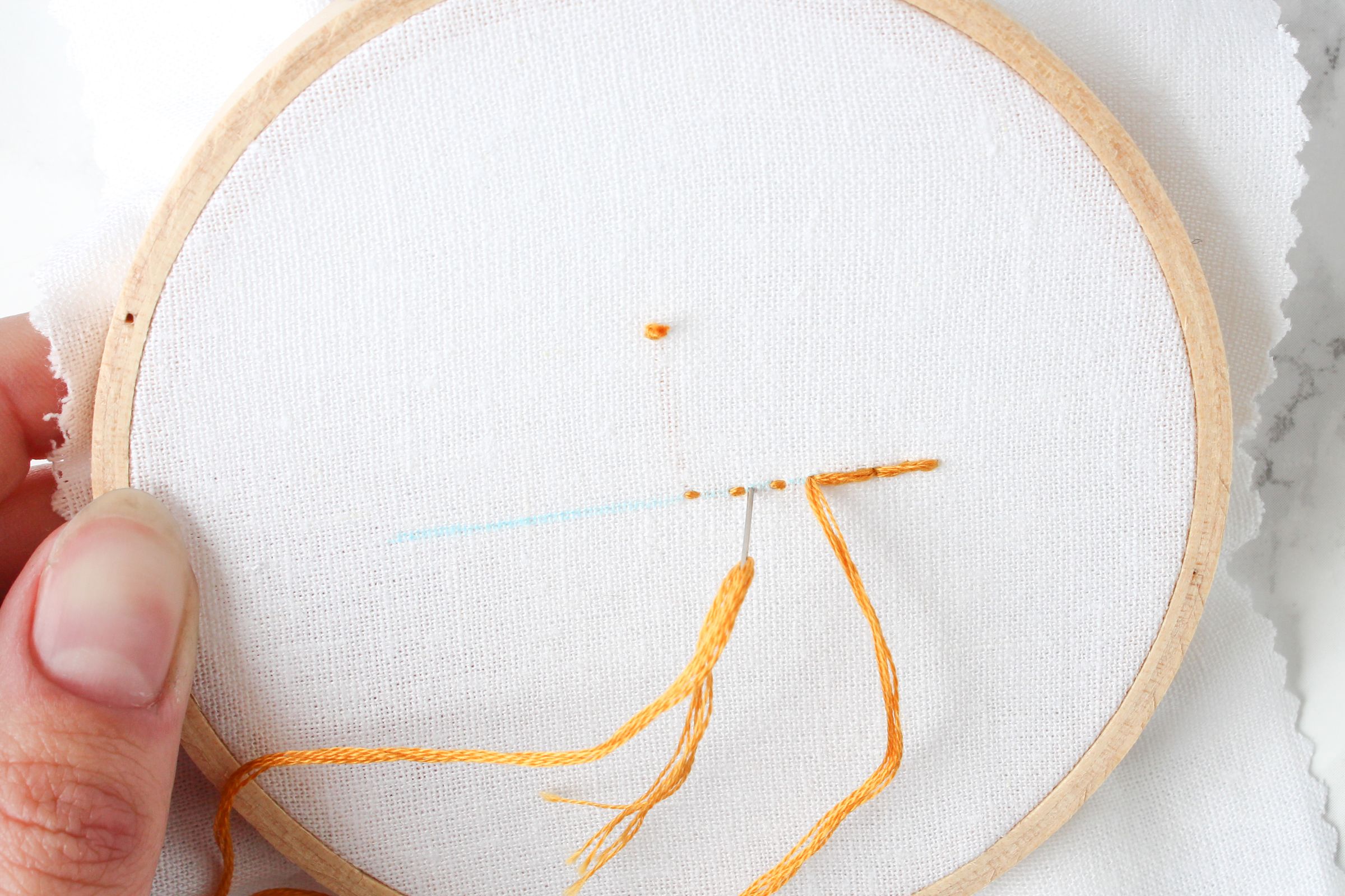

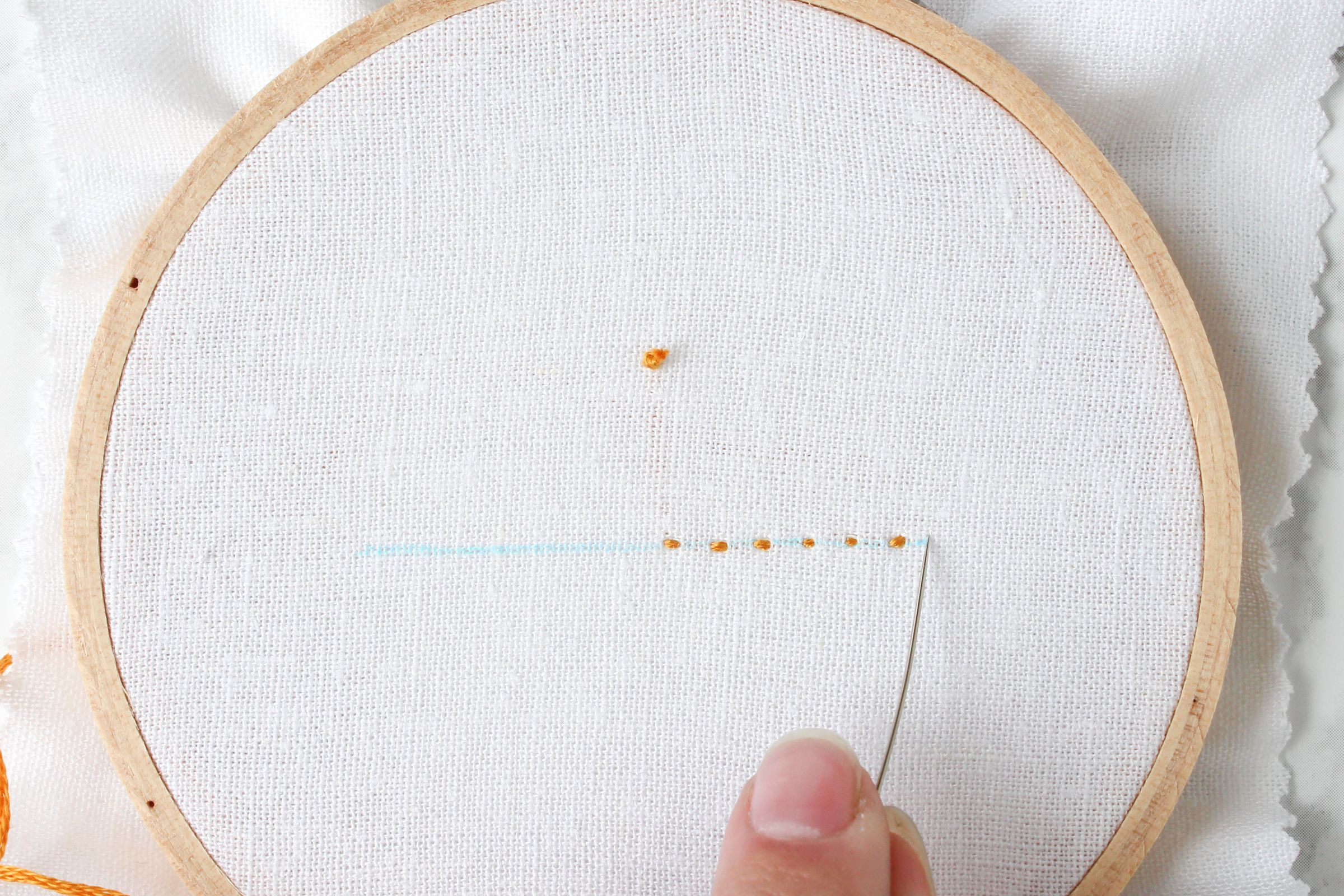

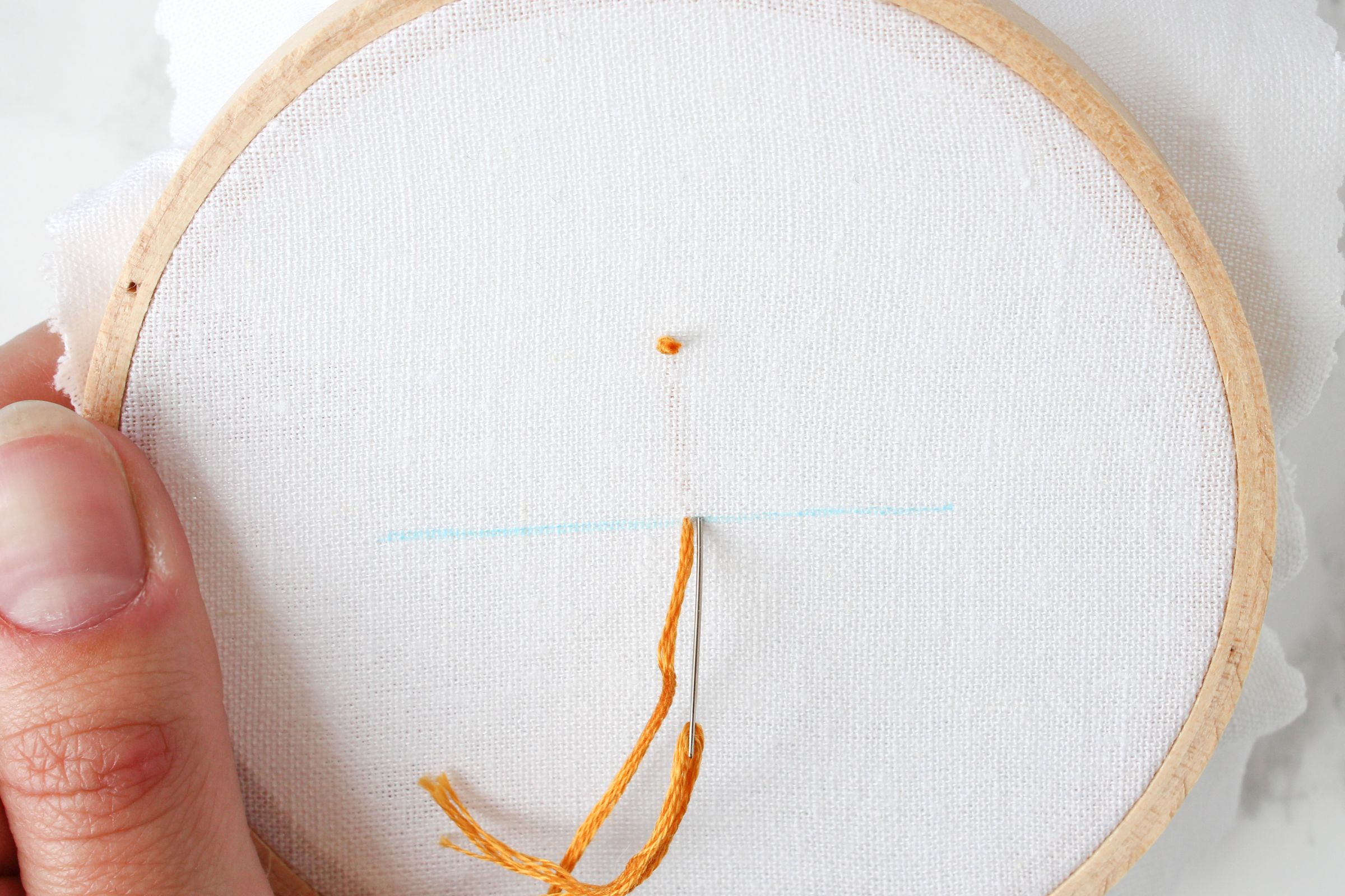

Then, bring the needle back to the front of the fabric at least an inch away from the end of the stitching line. Make tiny running stitches along the stitch line to where you want to start stitching. These stitches should be on your drawn line and only go over 1-2 threads of your fabric.
This is what the back of the embroidery should look like.

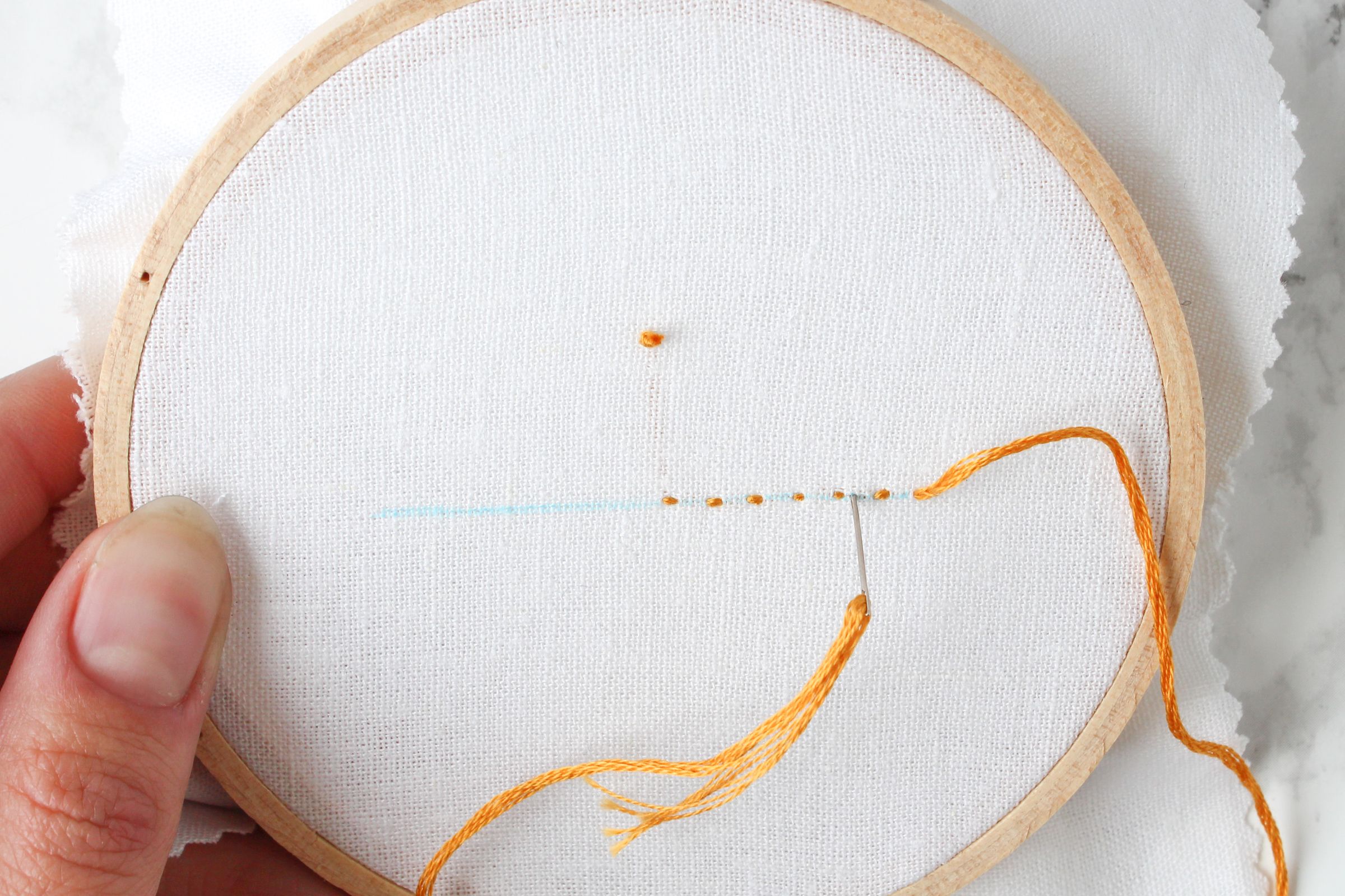

Now we're going to cover the tiny stitches with the actual stitching. Where I'm pointing with the needle is where I'll start stitching.

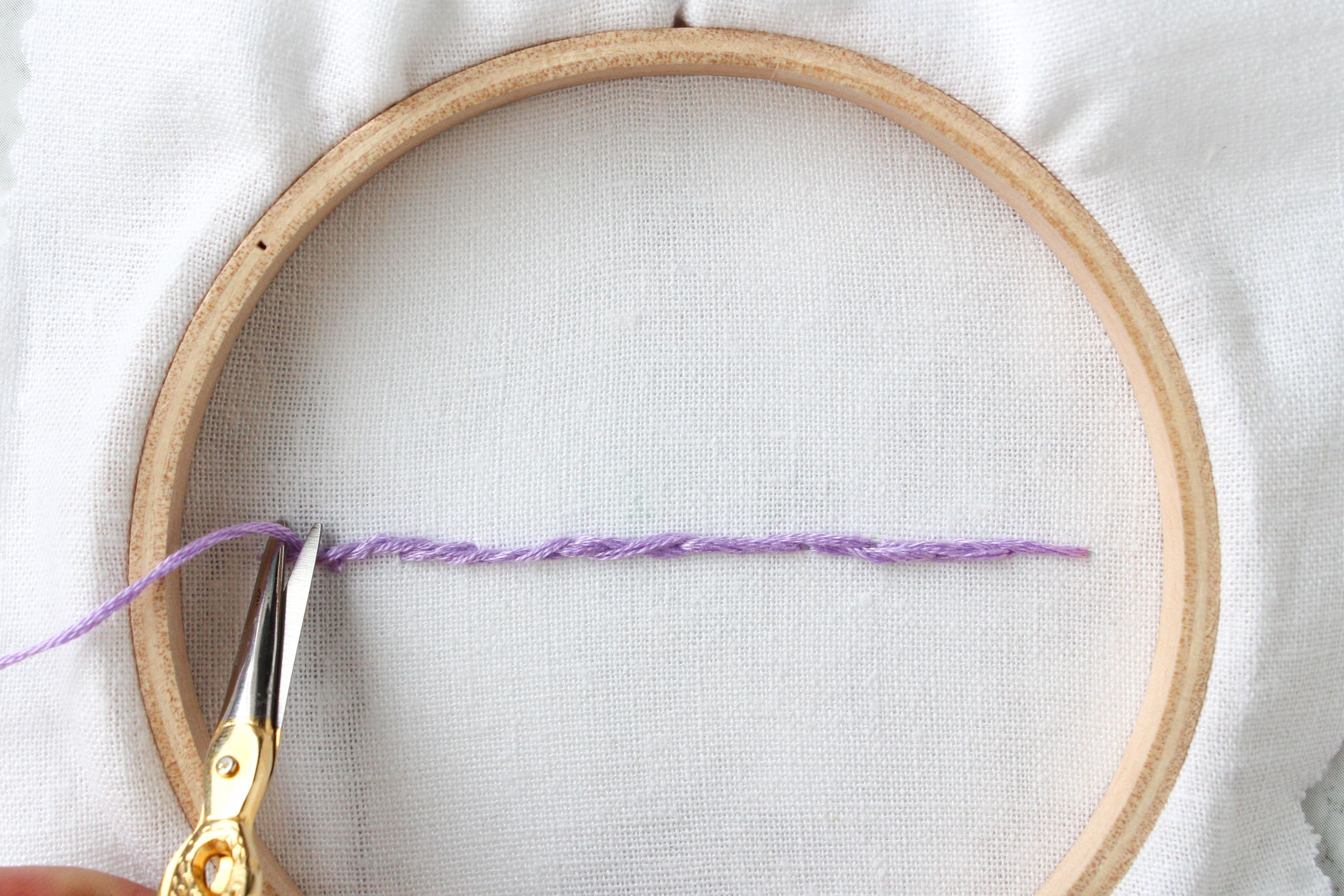

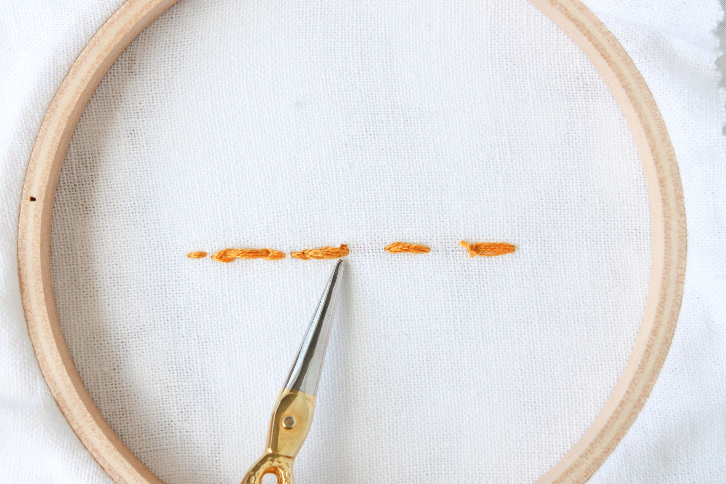

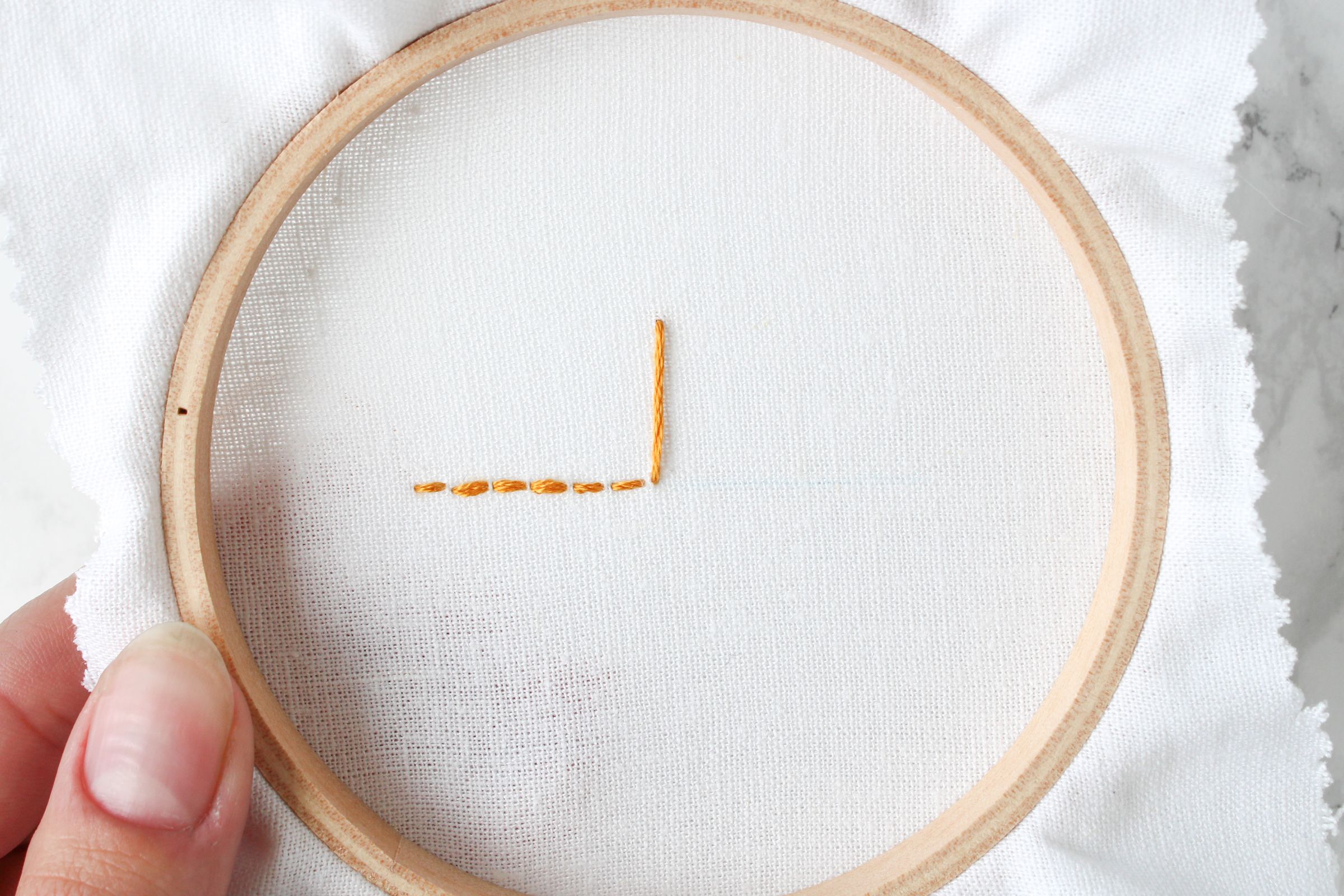

Stitch back towards the knot using whatever stitch you need, being careful to cover the tiny stitches you took to the starting point.

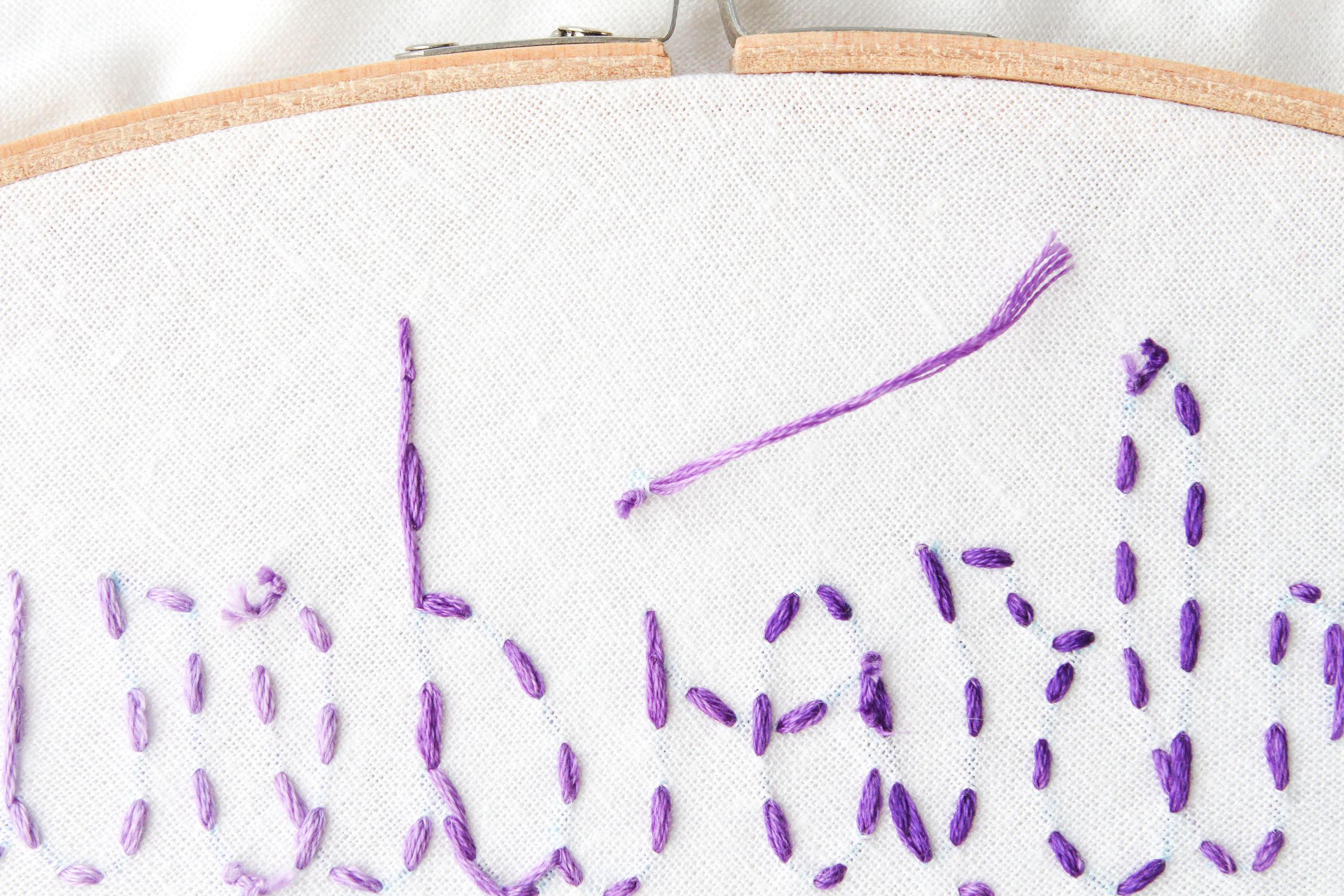

Once the tiny stitches we took in the beginning are covered with our actual stitches, we can cut the knot away. (Though I admit I prefer to keep the knot there until I'm done with that bit of floss or that area of the embroidery.)
Flip the hoop over and you'll see the tail that's left. Cut it off close to the stitching and you're set!
To finish the piece of floss you're working on, you can either knot it or weave in the ends. Here, I've knotted it.

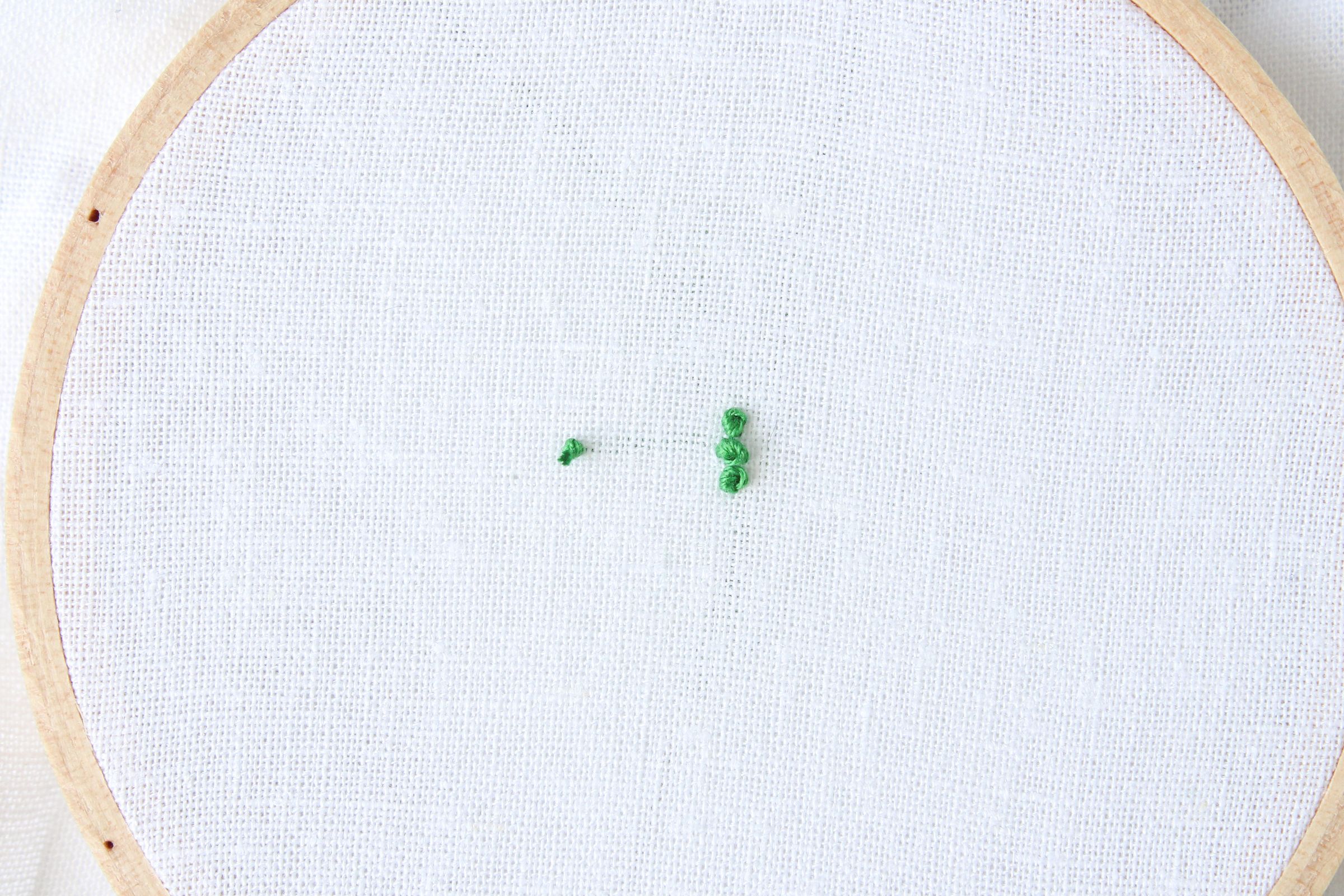

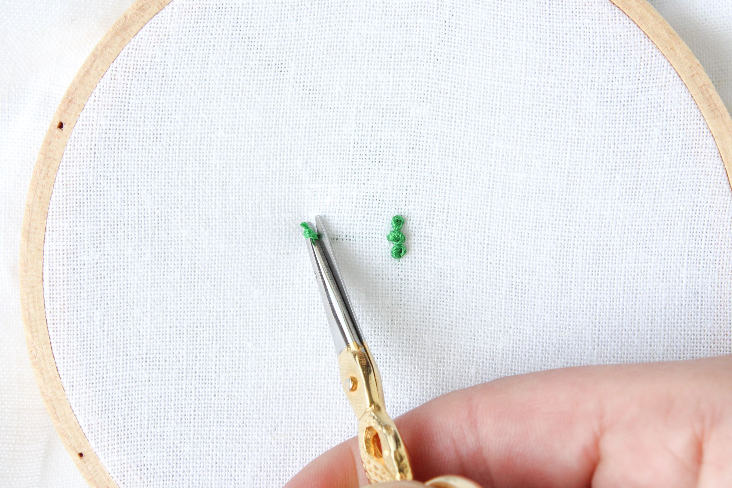

Step 3: Starting by Using Waste Knots on French Knots and Seed Stitches

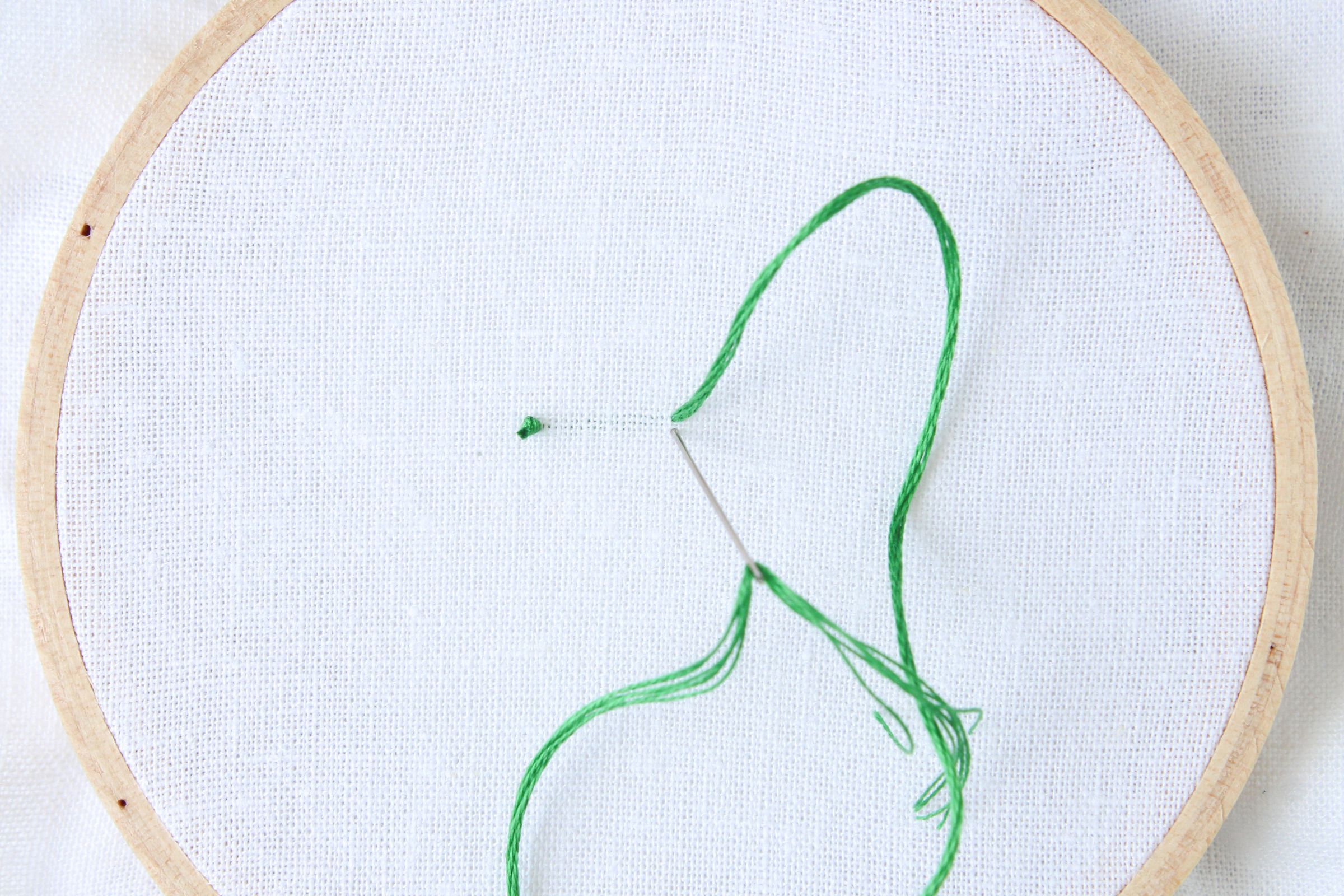

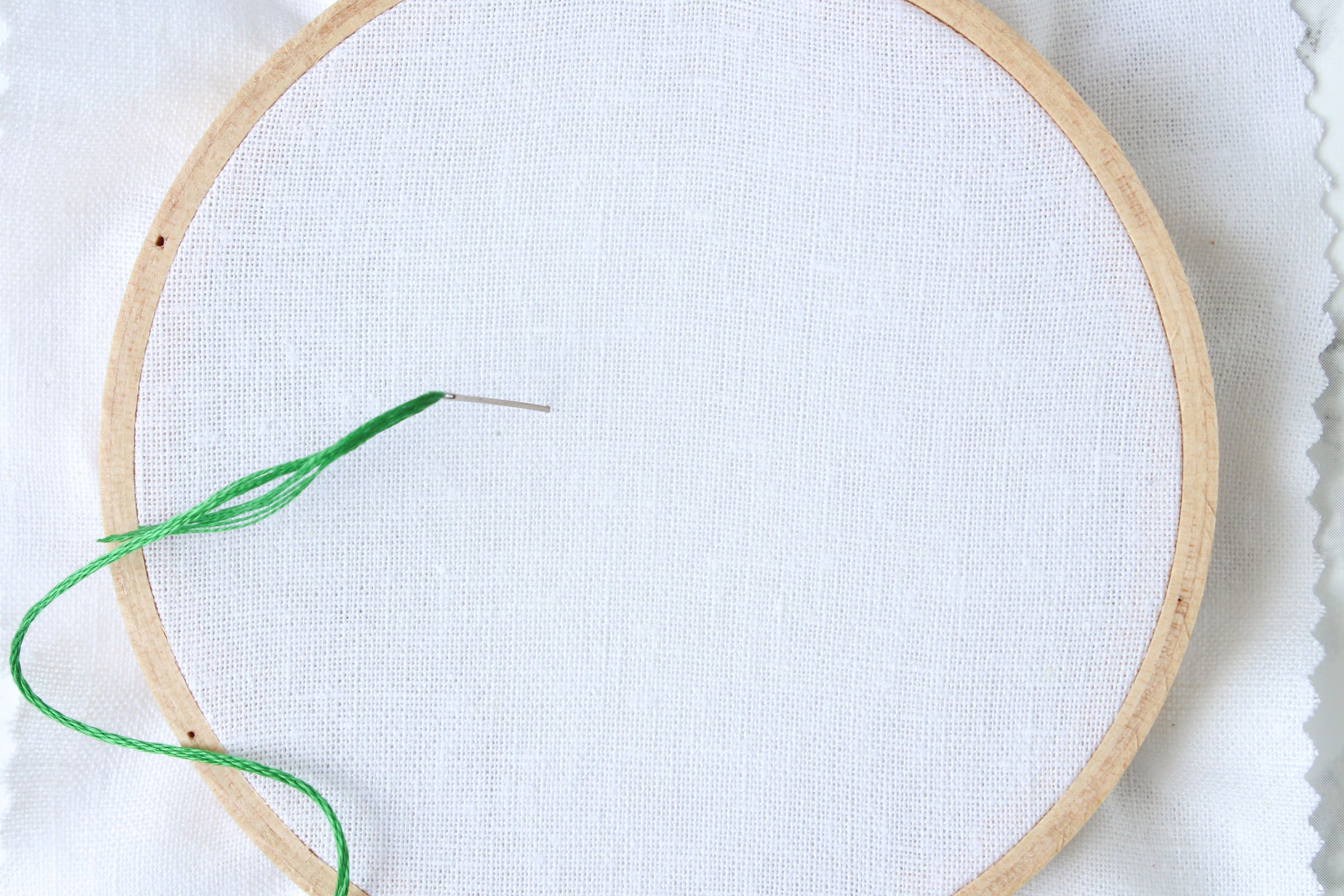

Put the needle through the fabric, front to back, about a 1/2 inch away from where you want to make the French knot. Pull it tight so the knot is sitting on the top of the fabric.
Bring the needle up right where you want the French knot or seed stitch to lay and make a super tiny stitch that goes over just 1 or 2 threads. (With my linen, I always do 2 threads - otherwise it can break under the pressure.)

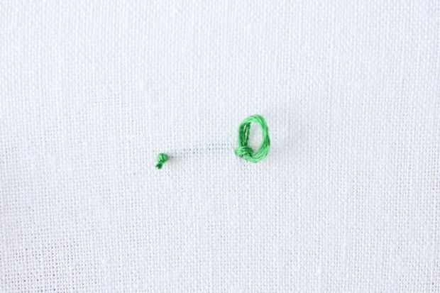

Then, come up on one side of the original stitch and make a French knot over it. Now you can keep on stitching! I added a couple more French knots.

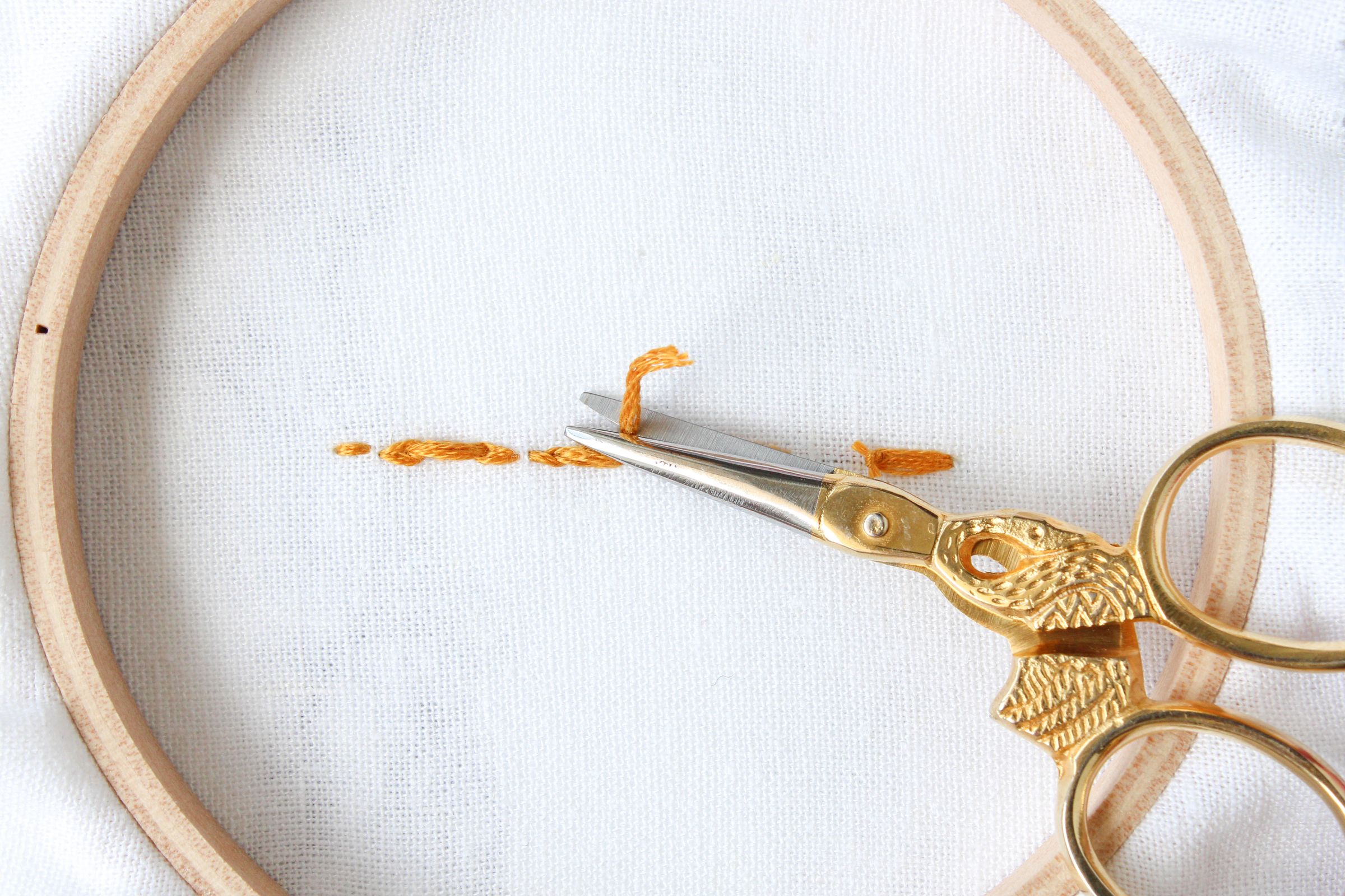

Once you're done stitching, cut the knot away and flip the hoop over so you can cut away the floss tail on the back.
And there you go! A clean start to tiny stitches.
End your stitching with a knot or by weaving in the ends. I always tie a knot.
