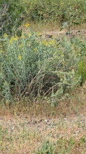

Bladderpod seed is best collected in the summer months, when the seed pods are drying but still hanging on the plant. Bladderpod is typically in sunny, relatively flat areas somewhat near a water source. Plant specimens at 2' in diameter or larger are your best bets for getting viable seeds. Look for a plant that is relatively accessible, has good sun exposure, looks healthy, and is clearly producing a lot of pods.

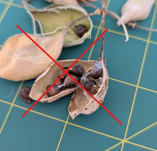

Following best practices for seed harvesting (see step 1), collect mature pods. These are usually located lower down on the plant and can be pale green or brown. If green, look for the seam on the pod beginning to open. Avoid pods with mold or mildew visible. Tear off pods and place them in a paper bag or other container.
photos:
  1. A mature seedpod. source. Copyright © 2015 Zoya Akulova
  2. Juvenile seedpods, leave these! source. Copyright © 2014 Neal Kramer

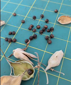

Open up your seed pods on a clean prep surface. Discard any of the following:
  1. The shells of the seed pods (compost ideally)
  2. Any insect litter, or insects (just put em outside)
  3. Seed pods or seeds with visible mold, or mildew, or intensive bug activity (compost)
  4. Any seed brighter than a "toasted marshmallow" in color. (compost). see photo for examples of the various colors.
  5. Small undeveloped seeds. viable seed is plump and round, with a small "tail" and a hard, typically speckled outer casing.(compost). See macro photo.
Keep your good seeds in a dry paper bag and they will keep for many months!

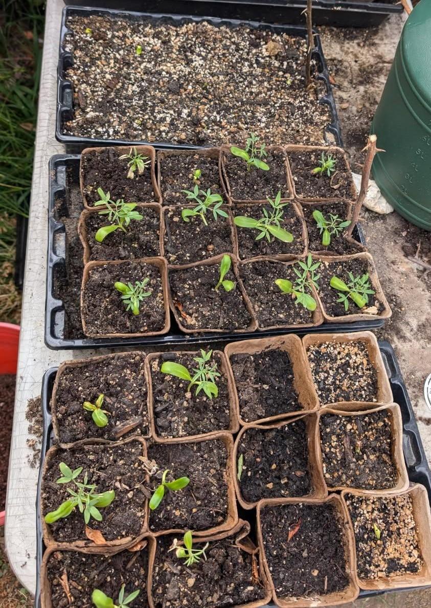

You should get a seedling with two seed leaves (Cotyledon) in a couple days after sowing, followed by a bunch of true leaves in about a week.
Water every 2-3 days , and make sure the seedlings have shade for most of the day for these first few weeks. This simulates being covered by a mother plant and prevents the seedlings from burning up.
When you have seedlings that have a developed cluster of true leaves, it's time to upgrade to separate pots! Use the same soil mix, and transfer the seedlings to these bigger pots using the spoon or shovel. Be mindful to not disturb the roots as much as possible. My technique is to leave about 1-2 cu inches of space in the new pot and place the scoop of soil from the flat right in there.
Keep up the watering schedule from earlier, and you may also start fertilizing with a low-burn fertilizer. The next transplant should occur when the plant's roots start to escape from the peat pot. You can follow the same process as the first transplant, leaving the peat pot in place ( it will help retain water and decompose over time).

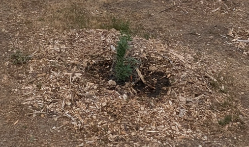

Dig a hole 2x the pot depth, and 50% the diameter. Refill about half of the soil loosely.
Dig a water basin. the basin should be about 2-3' in diameter (on the inside), and made with soil dug from a trench outside of the basin area (Not inside!) , piled into a Berm creating the edge of the basin.
Remove your plant from the pot, tease out the roots from the soil a little, and place into the hole such that the stem is right at ground level. Fill in remaining gaps with extra soil.
If you have mulch, fill the basin and cover the berm you made at the edge of the basin with it.
Water with 3 gallons of water, and repeat the watering 1-2x every week until the dry season begins (July or so)
