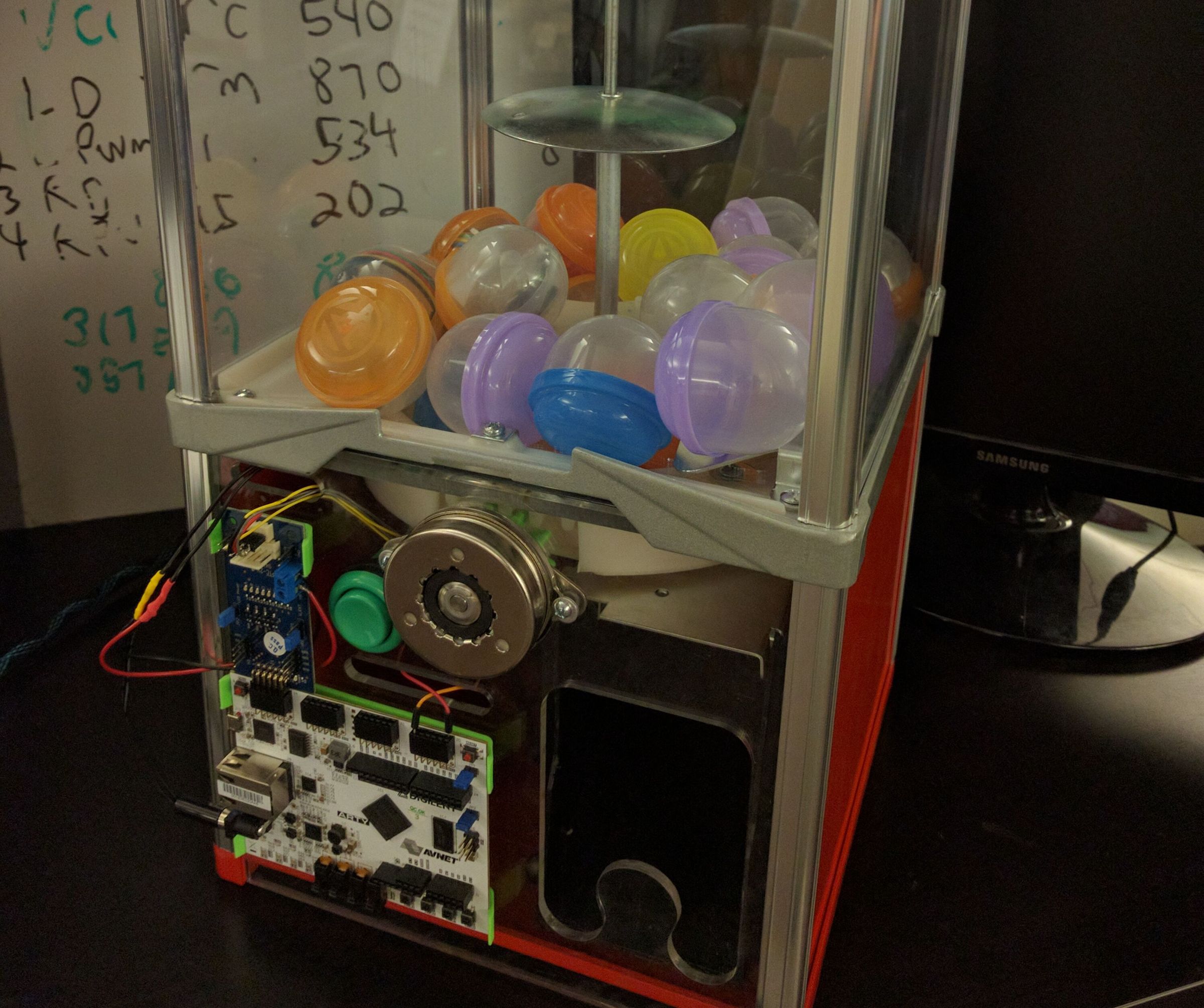

Introduction: State Machine Visualization for the Claw Game
The Claw Game's state machine is quite large so it would be nice to know exactly what it is thinking at any one time. To accomplish this we will add in a UART transmitter to communicate with an attached computer running LabVIEW. This can be adapted for use in any Verilog project.

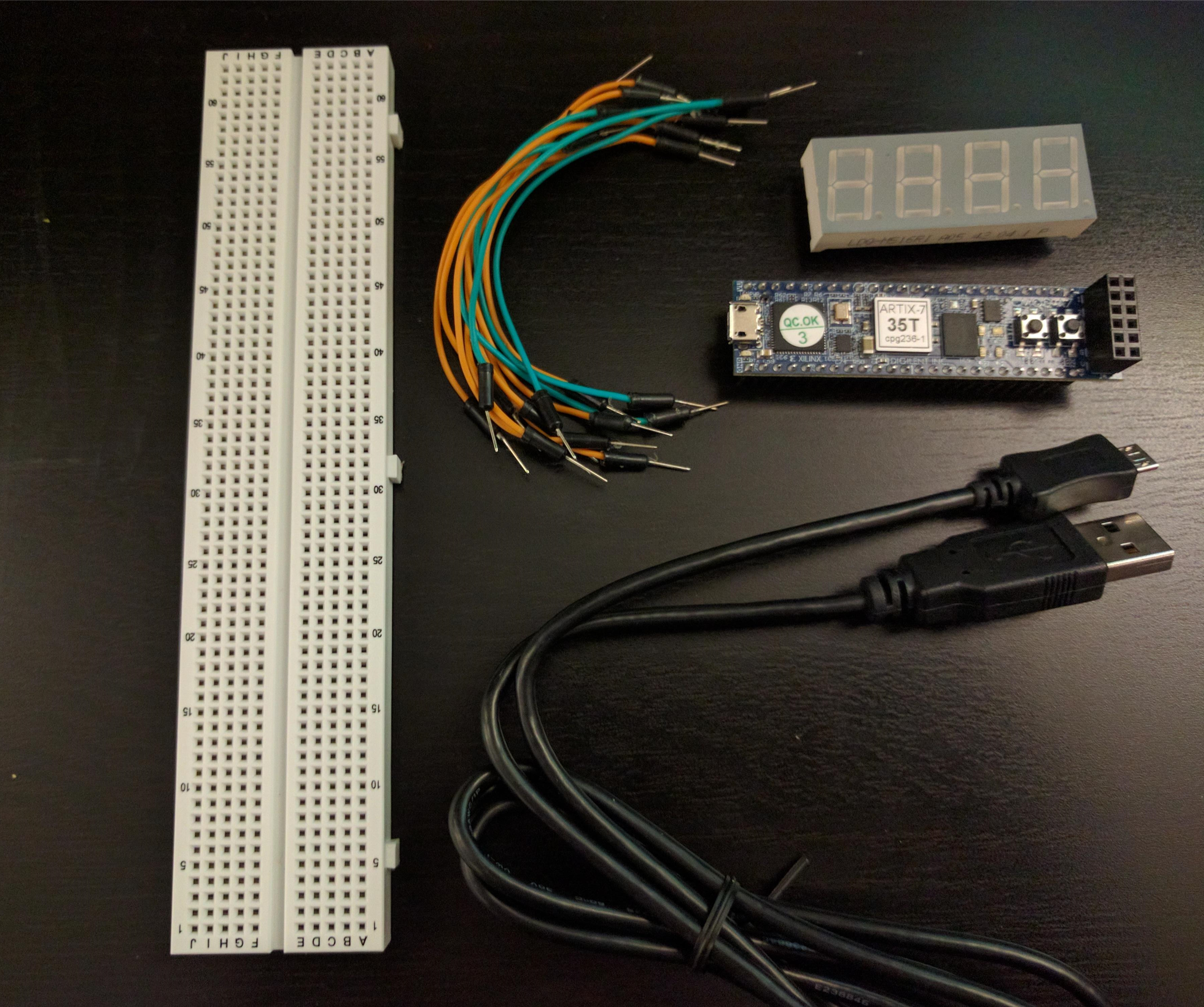

Materials required:
