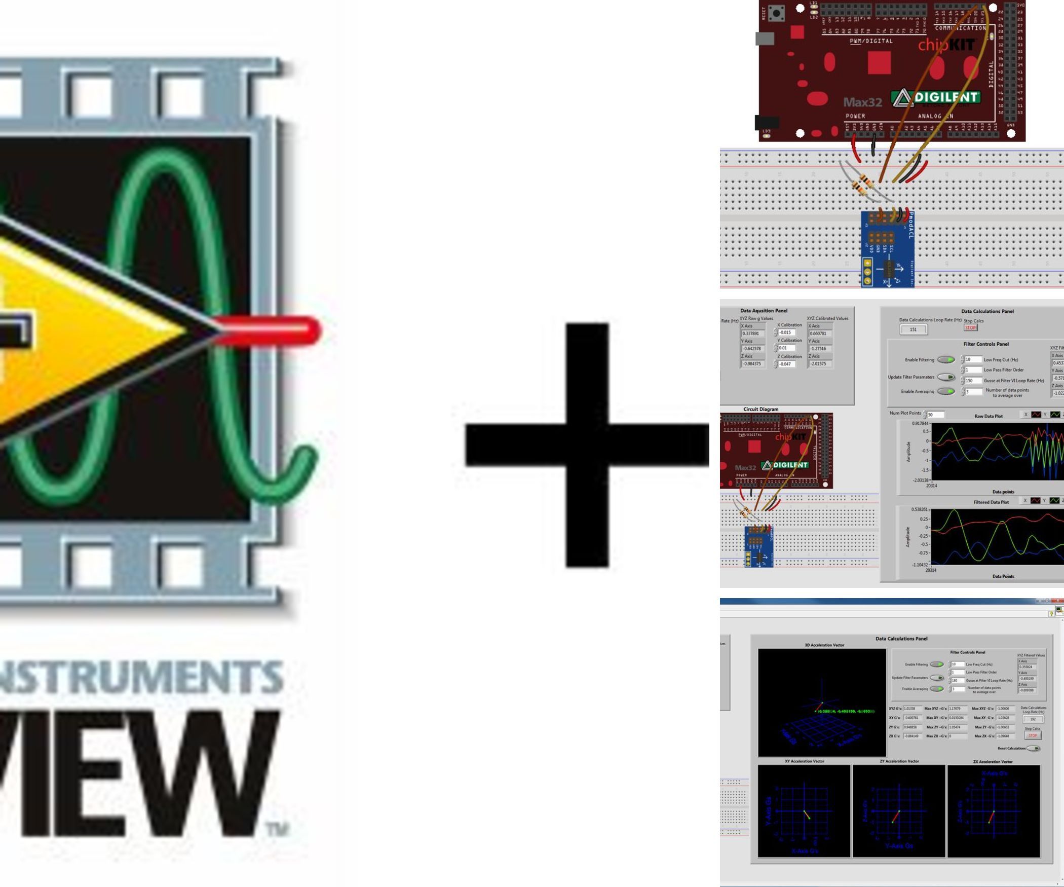

In this instructable I will go over how to build a tilt sensor (i.e measuring Pitch and Roll angles) using a single accelerometer. I have also included a “Gravity filter” that attempts to remove the effect of gravity from the accelerometer readings.
NOTE: I found out the design of this project is inherently flawed, but I decided to release it any way. The tilt senor can only make accurate readings while stationary. While Rotating or moving the sensor, the readings are WRONG. I’ll talk about this more in the theory section.To understand all of the code in this project, you must have completed the previous projects.
