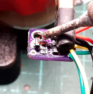

Step 3: Soldering the 0805 LED
Soldering the 0805 SMD LED
Soldering a 0805 LED by hand, on a breakout board not designed for SMD, is not an easy task at all. The following steps is my recommendation to solder the LED.
- Use the helper hand to hold your breakout board.
- Put some soldering paste on the edge of the SMD capacitor and the "XSHUT" pad.
- Use the soldering iron to put some additional solder on the capacitor edge.
- Put some soldering paste on both ends of the 0805 LED.
- Use the soldering iron to put some tin on both ends of the 0805 LED.
- Use the tweezers to place the LED as shown in the photo.The cathode end normally has a marked line. In my example, there is a green line on the cathode end. Place the cathode end to the capacitor end.
- Use the tweezers to add light pressure on the LED towards the capacitor, and solder the LED to the capacitor end, by adding heat to the capacitor end at the same time. Do not press to hard on the LED. Its cover may break under heat and excessive pressure. After soldering, add gentle pressure on the LED sideways, to test if the LED is soldered in place.
- Now solder the LED at the XSHUT dip pad. This step should be easier.
Note: The capacitor end shown in the picture is the ground terminal on this breakout board. And the dip pad XSHUT is pulled-up by a resistor.
Testing the LED
The LED should light up when you apply power (e.x. 5V) and ground to the breakout board.
