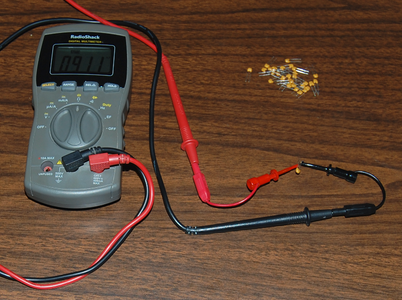

You will need a digital multimeter that can measure capacitance and a bunch of capacitors. I used thirty of these capacitors from Adafruit: https://www.adafruit.com/products/753
These capacitors are made by Vishay and the specified tolerance is -20%/+80%. I have no way of knowing if all the parts came from the same lot number or not.

The high numbers for CP and CPK indicate that the parts are well within tolerance. I was surprised to see the parts were all on the low side. I suspected that the manufacturing process would aim for the center of the tolerance range, at 130 nf. If all the capacitors they make are this good they could change the tolerance to +/-20% and still have a CPK of 1.6,
It appears that my meter reads consistantly, but another possibility is that my meter reads low. I know my meter is accurate for checking resistance, voltage, and frequency, but I am not sure about capacitance.
