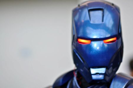

Step 7: Electronics
Materials I used:
-Helping hands
-Soldering Iron
-Solder
-22 gauge wire
-9v battery holders
-LEDs
-Scrap foam
-Hot glue
-Velcro
-Mylar folder
-Reed switch
1) For the gloves, I had a 9v battery holder which contained a switch. I wired and soldered this directly to my LEDs and hot glued the LEDs to the glove
2) I cut out pieces of a mylar folder in order to diffuse the LED.
3) For the eyes, I made eye boxes out of scrap foam and attached LEDs to the inside. More folder used to diffuse the light
4) LED eye boxes are then wired to a reed switch and a 9v battery holder. The reed switch closes the circuit when a magnetic field is present (facemask open, eyes off – facemask closed, eyes on)
5) For the chest piece, it was more or less the same with LEDs wired and more red folders to diffuse the light.

Step 8: Mechanizing Faceplate
Materials I used
- Small servos from hobby shop
- Push rods
- Pololu Micro Maestro 6 microcontroller + Users guide
- Wire
- 100 ohm resistor
- Soldering Iron
- USB cable
- 2 x 6v rechargeable batteries
- Chicago Screws
- Sintra
- Hi temp hot glue
- Apoxie Sculpt
1) I purchased hinge plans and installation guide from another Iron Man maker to save me the time of designing hinges, although there are a lot of other good sources on the hinge topic out there
2) I made the hinges out of sintra. I cut them to shape then sanded down the rough edges.
3) I glued Chicago screws into place for the hinges, and then used Apoxie Sculpt to fixate them in place. I sanded down the excess as well.
4) One I had smooth movement of my faceplate, I began the installation of 2 servos in the helmet. I experimented with different positions of the servos, but ultimately the initial suggestion of having the servos in the back of the helmet became the best working. I hot glued them which seemed to hold fine
5) I then measured and cut down pushrods to connect the servos to the hinges. I manually tested the motion in order to determine that the placement was satisfactory
6) I then followed the manual for the Micro Maestro microcontroller in order to wire a button to one of the chip’s channels. This will be the button that activates the servos
7) I followed the example script in the manual in order to have a push of the button activate servo movement. Once understanding single servo movement, I modified the script to move both servos
8) After having both servos in motion, I carefully modified the script in order to obtain the proper servo movement for my helmet. I noticed there was a point where the servos would rotate the hinges too far, thus warping the helmet. Once I reached that point, I returned it to a point where it would not warp.
Here's a short video of servo action on my second helmet using the same method:
