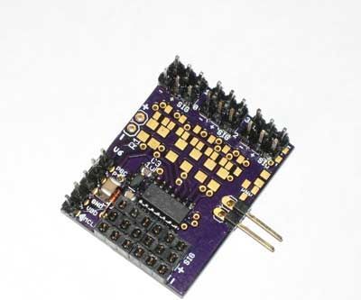

However, I also added head/tail lights and simulated gun firing with motion, light & sound. My old 6 channel 2.4GHz Spektrum DX6 ran out of knobs to handle everything, so I designed a small controller board to help.
The r/c receiver connects to the controller, which in turn drives the servos, lights, solenoid, etc... This one is long enough as is, so I've detailed the controller board & software in my R/C Controller Instructable. I've including the design files here though: Eagle schematics, Gerbers, source code & hex files.

The servo mount bracket holds the engine servos, whistle servo, R/C receiver/controller, and battery pack.
It's made from 0.032" aluminum and has stiffening flanges bent on all four sides. A pocket for the receiver is formed with a couple more bends. Most bends were made using a vise, block of wood & hammer. A Sheet Metal Hand Seamer is helpful also.
Drill pilot holes for the servo openings & metal nibbler to finish the shape. I removed the larger center using an adjustable 6" mini hacksaw. It allows fitting blades at different angles - not all hacksaws do. Drill 1/4" pilot holes, fit the blade through & reassemble the hacksaw. Carefully cut out the shape. File clean the rough edges.
Install the servos & mark drill holes. Remove servos, punch the marks & drill 1/16" mounting holes. Reinstall the servos and secure with screws.
The receiver & controller slip into the pocket. Pieces of cut-open 3/8" shrink tube & electrical tape insulate the electronics where necessary. The battery sits on the front of the bracket held by double-side sticky tape.
A power switch is attached to an small L bracket JB-Welded to a corner. The battery connects to the switch, the switch to the receiver/controller.

Step 26: R/C Details
I find the Spektrum DX6 a headache to setup for different models. Instead I tuned the tank to the transmitter. Two Microchip PIC 16LF1825's based controllers are used. One in the base attached to the receiver, another in the turret.
For some transmitter actions, the controllers range limit the servos (engines & whistle), other actions are converted to delta adjustments (turret rotation & gun elevation), and others into lighting on/off toggles.
The base controller also sends r/c receiver signals to the turret over a serial bitstream. Thus only three wires are needed: power, ground, signal.
With the Transmitter Right-Switch off,
Left-Switch = Whistle (range scaled & limited) Left Vertical = Left Engine (range scaled & limited) Right Vertical = Right Engine (range scaled & limited) Left Horizontal = Delta adjusted Turret Rotation Right Horizontal = Delta adjusted Gun Elevation
With the Transmitter Right-Switch on,
Left Vertical Up = Toggle headlights. Left Vertical Down = Toggle tail lights. Right Vertical Up = Toggle turret internal “map” light. Right Vertical Down = Fire gun (pulse solenoid, led, trigger sound driver). Left Horizontal = nothing Right Horizontal = nothing
I’ll cover the design & programming of the controllers in more detail in my R/C Controller Instructable.
