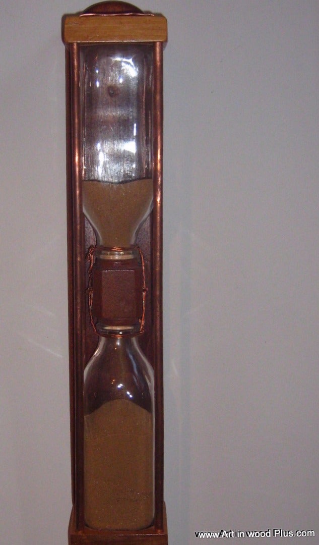

Step 3: The Remaining 3 Types of Wood.
The BASE. Wood 110 to 120 mm x650mm x30mm thick.
Round off both ends and give a curve all round. See pic'1 and 3.
In the centre, drill a hole 8\10mm right through for the pivit ,
in this hole drill another hole 35mm Dia' right through.
Turn the Base over,and the hole needs to be enlarged to 40mm Dia'
But only 10 mm deep.. Drill at each end hole 6mm...100mm from each end in,
to hang the timer on the wall.

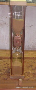

THE PLUG.Pic' 1&2.+8 I made a mistake and didn't take a full photo.
imagine..... 5 half dollars,one on top of each other, then put 15 quarter dollars on top of them. GOT IT??
This piece will have to be done on a lathe. The half dollars must be 40mm Dia'(15mm thick)
The quarter dollars 33mm Dia' .....length ( this will be determind when setting all things in place)SORRY.

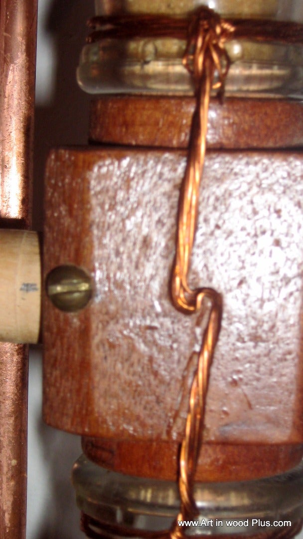

Put the sand into one of the bottles,3\4 full,add the wood that has the glass funnel,
put the 2nd bottle onto the other side.VERY carefully turn over, TIME how long it takes
for the sand to empty into the bottom bottle.REMOVE OR ADD some sand.
NOW twist 3 strands of the 3mm copper wire together,Weave the wire around the neck
of the bottle,over the wood to the other bottle and around the neck of the second bottle.
Turn both bottles over and return the wire back to the first bottle.
DO this pulling tight on the wire all the time. If need be, twist the wire that is over the wood
with pliers as shown in the picture.
Cut with the tube cutter,the copper tube into 4.Thread the 3 mm wire through one of the 2
white blocks,through 1 of the tubes and into the 2nd white block, thread the wire back through
the 2nd white block,through another copper tube and though the 1st white block..
Do this to all 4 tubes,as in the picture. Then knot the wire.
Put the plug, from the back into the middle hole of the BASE.
Put the extruding plug into the middle of the block ( hole is ready).
Turn the timer slowly round,as if changeing the sand flow.If all is well,not too tight,
then remove the bottles. put to one side.... The half dollar size plug should be seen
,from the back of the base,place the brass plate over the plug and hammer. 8\9 brass pins
so that the plug is firmly in place...put epoxy glue into the hole of the middle block,
and put the bottles back onto the 1\4 doller plug.Put a 2 to 3 pound weight onto the bottles .and wait till dry. HANG ON THE WALL ..where it can be turned without touching any thing .GOOD LUCK.
