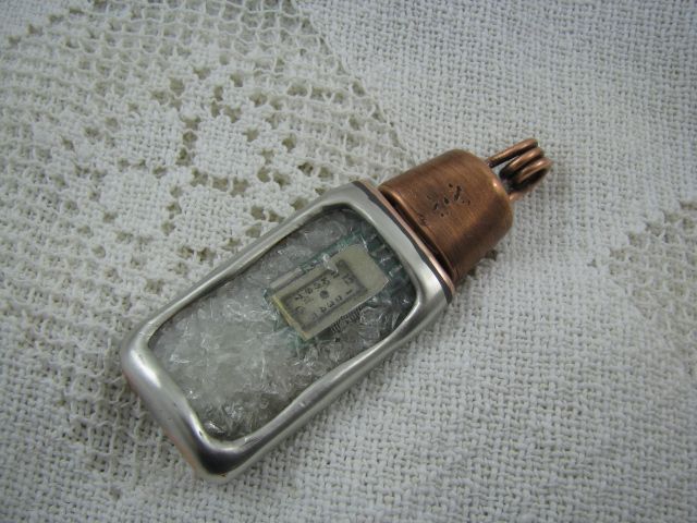

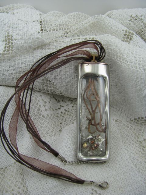

Introduction: Steampunk 4 Gig USB Drive
This drive is made of brass, copper, solder, watch parts and glass.
The cap screws on securely and the glass lights up blue when transferring data.
I like to think of this as a USB drive from the 1800s.
4 gig USB drive with Windows ready boost.

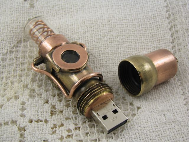

I was just wondering how you found the glass for the back? did u use an old light bulb or what? This is really cool! thanks for posting.
Reply 10 years ago on Introduction
Thank you,
It's a car headlight bulb I found at the local salvage yard. I do a lot of work with glass and have a special glass grinder that keeps the work wet while cutting. I'm not sure how you would cut one if you don't have access to a tool like that. The "heat and cool" method won't work and a traditional scoring glass cutter won't work either. A place that does custom glass work should be able to do it very easily.

What kind of solder would you use to do something like this? I haven't found any info that's descriptive enough. All i see is "solder", and not what kind. So far I've had to use hot glue to keep things together in my steampunk projects (which is a bad idea because of the residue). Anyway, I'd appreciate it if you'd tell me a kind of solder that works for this.
Most of the connections are are brazed with silver solder. It requires very hot temps that can only be reached with a fuel/oxygen torch. I use oxy/ acetylene.
The wire on the top is held with plumbers solder fron the hardware store and a 100 watt soldering iron. I don't use that solder anymore. I braze everything now and only use the soldering iron for electrical soldering.
How do you secure the usb drive in the middle inside the tube?
It's held in place with two part epoxy. I fill the plug end of the tube with epoxy before I slide the USB plug through. That way the plug is also held with the epoxy so it's very strong.
It helps to fill stick a piece of rolled up tissue in the plug to keep epoxy out of it.

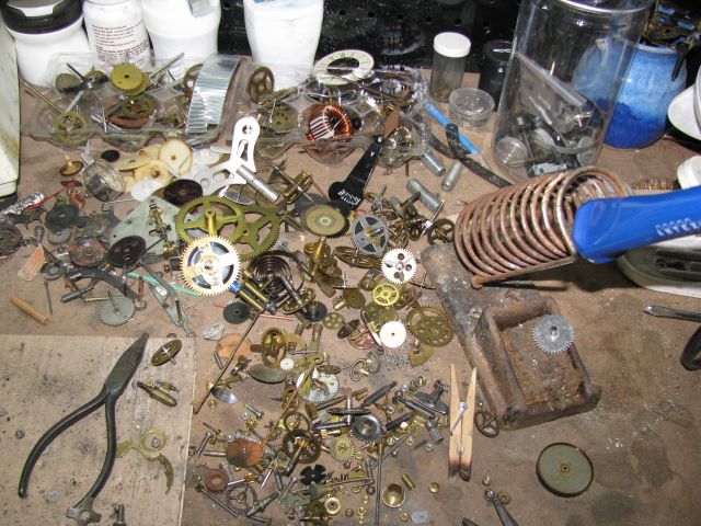

Thanks for the nice comments. I'd be happy to share some more details. This was my first slideshow and I never dreamed that it would generate so many views and comments.
The body and cap are made from copper and brass plumbing fixtures/pipes that I found in various flea markets, thrift shops etc... They could also be purchased new at hardware stores.
I use hard solder (1300 degrees) and an oxygen/ acetylene torch for most of the metal connections. The other metal connections are made with soft solder (375) degrees and a soldering iron or propane torch.
To shape the metal I use a bench grinder, belt sander, angle grinder, rotary tool, various files and sandpapers.
The light is from the existing LED on the USB card. There was no electrical work involved in this piece. I just made sure to design the case to show off the light.
There are no secret techniques used here. Grinding, soldering, scavenging and a lot of time.
