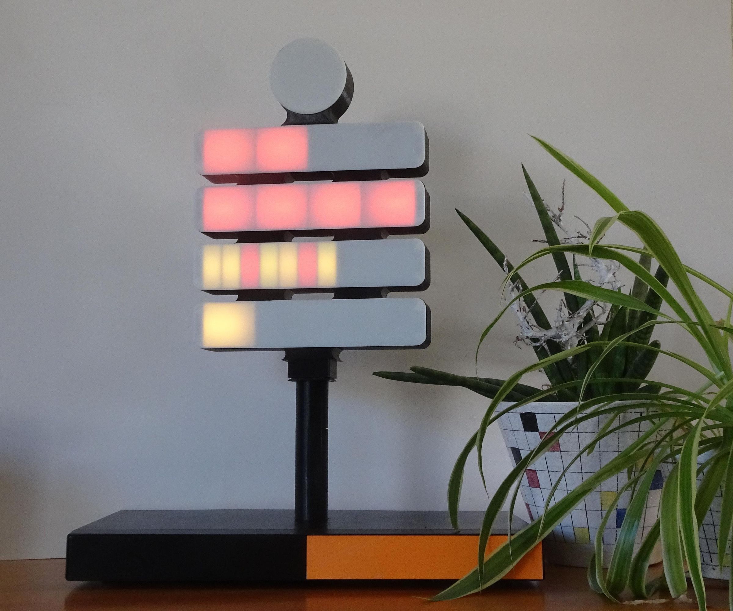

Step 4: Building a Case
My daugther had designed a case only by two words: steam punk and art-deco. From while to while she would send me some existing designs with the question wich i liked best. After some time she came up with a great design. It is simple and elegant. It has three blocks with a meter and for the show two vacuum tubes and a OLED color display. First I wanted to use a antique tube called cat-eye. I didn't because of the requered voltages (250 V).
Center Clock (CC)
The middle clock (CC) you can see in the cad drawing.
- CC Front 116 x 116 x 9 mm
- CC Back 116 x 116 x 9 mm
- CC Right 98 x 98 x 9 mm
- CC Left 98 x 98 x 9 mm
- CC Top 116 x 98 x 9 mm
- CC Bottom 116 x 98 x 9 mm
Right and Left Clock (RC and LC)
The right and left clock are exact mirrors of each other.
- LC/RC Front 100 x 91 x 9 mm
- LC/RC Top 82 x 62 x 9 mm
- LC Right/ RC Left 140 x 80 x 9 mm
- LC RRight / RC LLeft 40 x 80 x 9 mm
- LC/RC Back 100 x 91 x 9 mm
No bottom !!!
