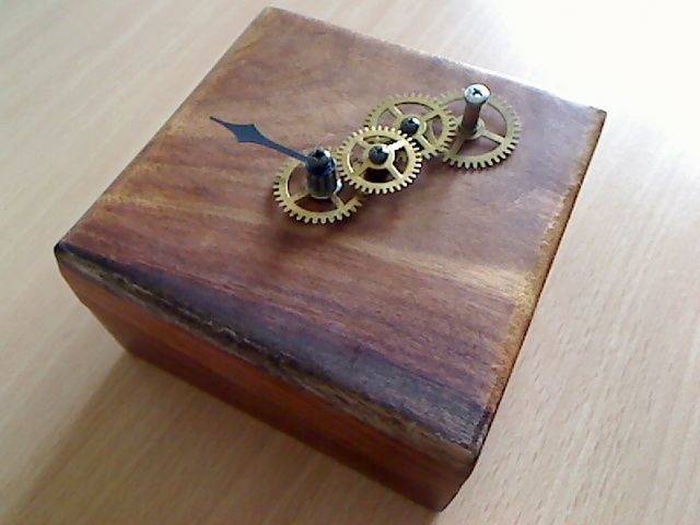

Step 3: Connect the Cogs.
This was trial and error. I went to a local clock repair shop and got cogs that geared up from 1 to around 4. This gave me a 90 degree turn on the servo equal to roughly 360 turn on the final cog.
To test the positioning of the cogs before I started putting them into the final box I put nails through them and tried them out on some scrap wood.
To begin with I drilled a hole in the lid of the box big enough to fit the shaft of the servo and screwed the servo to the inside of the case. On the outside I then screwed and glued the main drive cog directly into/onto the shaft of the servo.
All other cog are free to rotate around simple screws.
The final cog has an hour hand from a clock glued to the top of it. This allows the cog and hand to move together freely around the final screw.

Step 4: The Source.
After playing with the gearing between the first and final cog it turned out that moving the servo from 80 to 145 give a full rotation on the compass cog.
The attached code should pretty much speak for itself.
Step 5: The Final Device
I didnt position the cogs close enough to each other so there is a little play between them. the hour hand can move about 10 degrees without the servo cog turning. So the acuracy isnt quite as good as it could have been.
This device can easily be extended and turned into a Steampunk Goecaching unit.
But that aside it looks pretty good on my coffee table at home.
