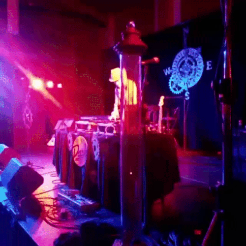

As the title of the event was "Steampunk Ball 2: Tesla Boogaloo" we thought it would be appropriate to build a large jaccob's ladder to show off some of the high voltage electricity Tesla is so well known for.

To contain the electronics we built a wooden box and cap which worked with the Steampunk theme. The wood pieces were cut with YuKonstruct's CNC router.
The protective plastic tube was purchased online and the box and cap were designed to match its measurements.
After it was assembled, the casing was painted with acrylic paints in metallic colours.
