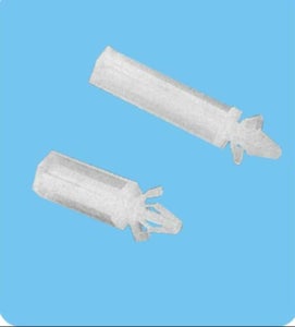

Add PCB spacers to separate the device from the bottom of the box.

Add adequate PCB spacers to maintain the board horizontally.

Because using PCB spacers is too problematic due the high position, put a wood stripe side to side to hold the board on place.

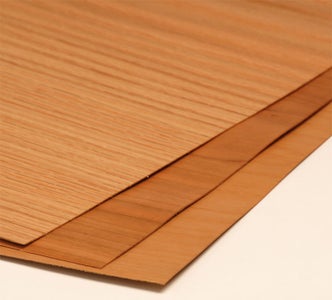

Step 9: Wood Veneer
Veneers are very thin slices of hardwood usually thinner than 1mm and come in many sizes and colors. Some come with paper backs or adhesive backs (like peel and stick).
I use just plain wood veneer and contact cement.
They are typically glued on to solid hardwood, or a substrate of good quality hardwood ply or medium density fiber board.
It really is as simple as gluing it down to a piece of plywood, and trimming the edges.
Begin by sanding the substrate surface if necessary. Clean off the sawdust with a cloth and make sure it's free of debris.
Place the veneer over the area of wood that you want to cover. Use a pencil to mark the area where you need to trim the veneer. Be sure to cut it a little bit bigger than the area you are covering. This allows you a margin of error. Once you have determined where you will trim the veneer, use a cutter to trim off the excess pieces.
Lay your veneer out on top of the table, with the back facing up. Roll a coat of contact cement onto the back of the veneer. Work to get it as even as possible. Set the veneer aside where it can dry without getting dust in the glue.
Roll a coat of cement on the surface of the box in the same way. Wait until the cement is dry to the touch, typically about 10 minutes.
Lift the veneer up and position it over the box so that it overhangs every edge of the box.
Use extreme caution when positioning the two elements for adherence. Since contact cement is so slip-resistant, they must be perfectly aligned on the first try.
Press the end of the veneer firmly onto the box, starting in the center and pressing it toward the outside. Use a well sanded block of wood to smooth any slack out of the veneer.
Trim the edge of the veneer around the sides of the box by pressing the blade of a utility knife down, against the edge of the box to cut the veneer flush against the box. Trim all four sides in this way. Sand the edge of the box with a hand sander and 120-grit sandpaper to smooth the edges of the veneer.
Repeat the process until to cover all visible surfaces.

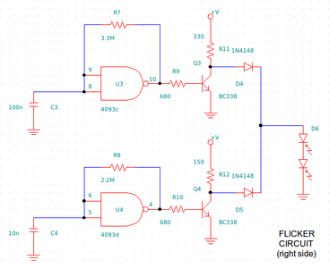

The movement of the needle is caused by a section of the flicker circuit.
The resistor value was found by trial and error to make sure the needle does not leave out the scale.

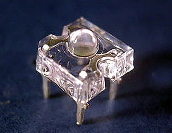

A square orange high brightness LED is connected to each end of the rods under the cover.

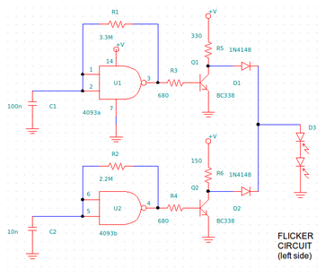

Step 18: Flickering System (electronic Circuit)
The NAND Schmidt trigger 4093 gate can be used as a simple astable timing circuit as shown in any digital electronics book. The Schmidt trigger basic operation works when the input voltage reaches a specified voltage level, the output changes states. Thus when the input goes below another specified voltage level the output will return to the original state. Because of this action we can make this IC a timer by the use of a resistor and a capacitor.
In the schematic (see the picture) the circuit works as follows: The voltage charges the capacitor coming from the High output of the NAND gate until it has reached the threshold voltage value. When this threshold is reached the Input A, B is High thus the Output of the NAND gate is now Low. When the discharge voltage threshold is reached, Input A, B is Low and this makes the Output High once again, thus charging the capacitor up again. The NAND gate will keep on repeating this cycle of charging and discharging to produce a square wave timing frequency. The NAND gate produces a square wave pulse frequency that can be adjusted by lowering or raising the values of the capacitor and/or resistor to change the frequency output of the NAND gate. The Resister and Capacitor (RC) values determine the timing frequency of the RC circuit.
The output of the NAND gate goes through a limiting resister (680 ohm) that bias the base of transistor BC338 to turn the transistor on/off at the frequency of the RC NAND circuit. The transistor is used as an on/off switch to turn the LED on/off to produce the simulated flick effect. The Common Emitter configuration’s output goes through the switching diode 1N4148 to maintain positive current direction going to the LED that turns on and off the Orange LED. The orange LED’s produce a simulation of flickering that is adjustable by the trimpots.
The two timers are configured as low-frequency oscillators, operating at non-harmonically-related rates (this is important to the appearance of "randomness")
Hence, we have four discrete resistances controlling the current thru the LED (producing four discrete brightness levels):
- Off
- R5 only
- R6 only
- R5 paralleled by R6
Since the oscillator frequencies are unrelated, this yields the appearance of a pseudo-randomly-occurring flicker.
The circuit described here fills the bill without using a microcontroller.

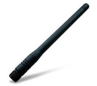

The unique role of this box is to serve to stand the wifi antenna.
Originally would have gauges on their sides but during assembly was decided to transfer them to the main box.
This box must be worked in the same manner as in step 3 because its bottom must be removed to allow passage of the antenna cable.
After sanding and finishing place the gears. Gears serve a purely decorative mission and were obtained from an old clock.
Perforate the top in the center and place the plastic antenna mount. Place over it a brass ring (the visible plastic is not “steampunk compatible”)
Request for help: many hours of sleepless were the result of trying to modify the original antenna toward something more steampunk.
The antenna finally retained its original form until further notice :(
I would appreciate your ideas for improving this. Thanks in advance.

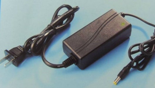

Originally the router and adsl modem were using each a 12 Vdc power supply and the network switch one of 9 Vdc.
With that in mind the flicker circuit was designed to operate with 9 volt and then use a single source 12 V and a simple regulator to reduce to 9 V.
The power supply connectors of the two 12 Vdc boards are visible on the rear panel of the box therefore laces covered wires were placed.
On the top right corner is placed the power connector and at his side the flicker effect on/off switch.
The external power supply provides 12 Vdc at 3.5 Amp.
