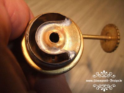

Step 2: Steam Generator
Now I widen the middle tube a little with a big screwdriver.
Now you can stick the Steam-generator in this tube.
Then you drill a small hole 2,5mm into the bottom plate.
Make sure that you don’t drill near or into the tooth for the adjustment.
Stick the wires through this hole.
You are finishing the mounting of the Steam-generator.
