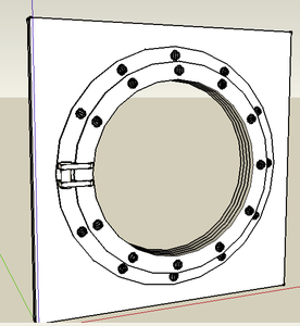

The first step was to figure out what we wanted the porthole backdrop to look like.
A 3D model was designed in SketchUp in order to work out the size and shape of all the pieces.
The backdrop consists of a large flat square with a hole in the middle and then layered rings over the hole.

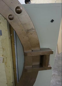

A CNC router was used to cut out the pieces for the porthole's faux hinge.
Instead of carving out the round tops of the faux rivets, we purchased foam balls from a craft store and cut them in half.

We stuck all the pieces together with construction adhesive and patched the seams and cracks with filler. We weren't too worried about making it look perfect since our finished product was supposed to look weathered and old.
We wanted to paint the porthole with metallic spray paint but if you try to spray paint on foam it will melt. To protect the foam, we covered everything with a few coats of white glue.
The glue worked fairly well on the ring pieces, but we had a lot of trouble with it bubbling and cracking on the large back pieces. Next time we will use something different to seal the foam.
