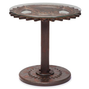

The table that inspired this design was a rustic table created by Z Gallerie, which they appear to no longer sell.
The only aspect that remained similar in the final design was the general shape of the gear as the table top. I wanted to employ more of a rugged steampunk design to my tables, so I incorporated the castellated curved I-beams as the legs.
