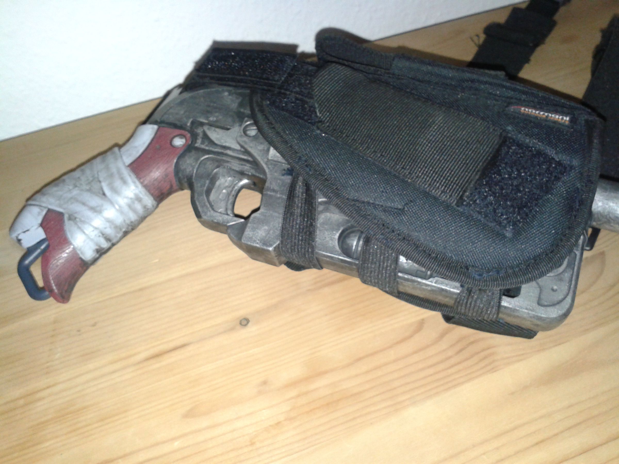

Step 3: Blaster's Marriage
Cut out the needed parts of the smiffy’s body (see picture) using a heated carpet knife – which works fairly well.
Cut down the internal holders with the Dremel so that the parts of the shell can be attached directly on the previously unmodified Jolt.
In order to be able to place the dragon’s barrel over the Jolt's barrel, it is necessary to cut a gap into the upper end of the Jolts trigger guard (mine was about 2 mm wide, but 1 mm should also be enough). Also, you'll have to make a cut-out for the Jolt trigger.
Step 4: Modelling
Now align the barrel's front part. Fix it with hot glue, then glue on the halves of the dragon's head onto the sides with exact fit. In addition, you can use 2 of the original screw fittings.
Not visible in the pictures is that there will be a huge hole beyond the dragons head resulting from the cut off handle of the original blaster. Close it with fine gypsum-based levelling compound or whatever you find sufficient for this. The muzzle can be modeled from 2 components epoxy putty by using the round edge of a sculpting tool.
Fill the screw holes, the channel of the original plunger rod and the gaps between Jolt and the dragons head with epoxy putty, too.

Step 6: Fine Works
To cover the Nerf logos, brass ornaments (available by DIY jewellery supplier) can be used. Bend them to match the handle of the Jolt and glue them on using instant adhesive. Cut off the end of the jolts plunger rod and drill a hole with a 4mm drill into the rod.
Screw in a brass wall hook from the hardware store to the cocking mechanism. Covering the screw with instant adhesive will prevent further rotation. Finish it with a random matte clear spray varnish.
