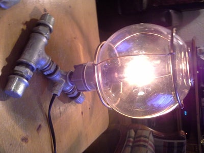

Introduction: Steampunk - Pipe Lamps,industrial
Just a few lamps i made from some plumbing materials.
Step 1: Materials Needed :
glue, some spray paint and the parts on the photo's.
the glas is optionel, just use your own find....

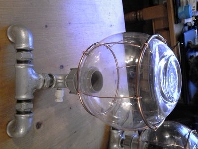

Step 2: The Wires on the Glas
On the glas vase i made some wire just decoration, its up to you if you want it.

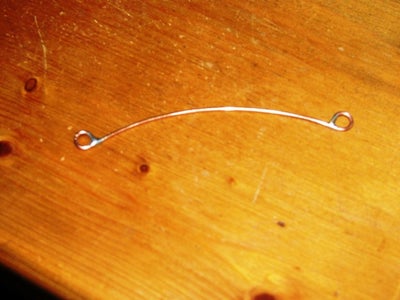

place the rings on the vase like shown, measure the distance, and make at least 4 cupper wires as shown on the picture..
or 6the ..... next is to arange them on one side, then put the glas in the middle and slide them in place...
the smal ring i glued on one of the glas vases is just another decoration....

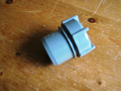

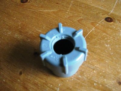

Step 3: Preparing the Glas

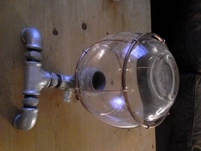

make a hole the size of the fitting, glue it, also glue the plug in the glas.....
next is to place the lamp socket end connect the wire.... beware there is no damaged wire,,,,,
next thing is to place the glas on the socket and ready.....
