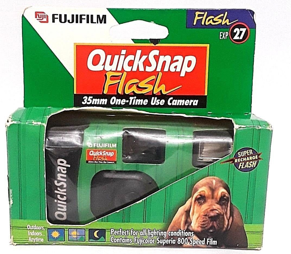

I too have found that the AA transformers are far better when running from 1.5 volts. However, it is becoming very difficult to find AA versions and Fuji's packaging has further complicated this. the AAA versions had a circular or oval lens frame and the AA version had a lens base that was squared on one side and round on the other.
Look at the 4th picture I uploaded. The one with the box AND the camera. This is the box that I opened today, with the camera that was inside... Ooops!!! misleading... (at least for junior mad scientists)
The 5th picture I uploaded is a "Fujifilm QuickSnap Flash 35mm One-Time Use Camera 800 ISO 27 exposure" which I purchased from eBay, and did, in fact turn out to be a AA unit.
mr jimboto, esq.
