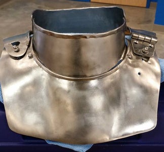

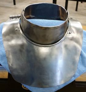

Step 5: Add the Hardware
It's hard to describe how this articulation works, study the pictures (especially the last one above) to get an idea of what it should look like when you're done. We permanently attach a hinge on one side, but that hinge needs to rotate on one side so the whole piece can be opened up and wrapped around your neck and shoulders when you put it on and take it off. It is held in place by hooking a hole in the front plate over a post on the back plate.
First we'll attach the hinge. Attach the hinge to the one side. The side of the hinge that attached to the front plate needs to be attached with two rivets and does not move. The other side of the hinge (the long side) will attach to the back plate with one rivet loosely connected so it can rotate on the plate. Use a washer in between the plate and the hinge so the rotation is smooth.
Attaching the rivets was tricky because the holes predrilled in the store bought hinge were made for wood screws, not rivets so the holes were way too big. Try to get a hinge without pre-drilled holes or make your own hinge if you have to.
On the other side of the gorget, attach a post. There are lots of ways to create a post, but I did an easy cheat. I drilled a hole and attached a machine screw and washer through the bottom of the plate and held it with a nut. Then I decorated it with an acorn nut on top. Then I ground away the screw threads until it was a nice post.
Punch the hole for the other side to fit over it's post. Don't drill the hole, use a whitney or other punching tool. I drilled mine and it caught in the drill and wrapped the whole piece around the bit, tore the hole and nearly ruined the whole piece. You can't see the tear from more than a foot away and it will be covered by the breastplate straps and pauldrons, but it will keep growing as the armor is used and eventually the piece will have to be repaired with a TIG welder or just replaced.
You can see in the pictures that there's a groove leading from the hole drilled for the post towards the back. You can cut a groove so the piece can slide along the post and lock in place, but I'm not sure how necessary it is. The way it's positioned the piece slides straight back when you get hit in the front throat, there's nothing to hold it place. The next piece I will try leaving out the groove entirely or think of some other attachment mechanism.
Step 6: Create the Lames
Lames are the vertical pieces that wrap around and protect the throat.
First create a cardstock template for the front an back lames. They should fit vertically inside your chest and back pieces. They should also be high enough to protect your neck from blows, but low enough to keep from breaking your jaw if you fall or get hit on the head from behind, or breaking the back of your head if you fall or get hit in the head from the front. Yes it's tricky and there are painful decisions you need to make about the tradeoffs.
Notice that in photo that I left tabs at the bottom of the pieces that can be folded perpendicular to the piece so it can be riveted to the front and back plates.
Shaping the collar is easy, just bend it over your thigh into a C shape, and just use your hands to shape it so it fits snugly in the front and back pieces.
Curl the tops and bottoms of both lames.
Finally, fold over the tabs so they fit against the front and back plates. You'll probably need to hammer them into a concave so they fit flush against the concave of the front/back plates.

Step 7: Attach the Lames to the Plates
Now we rivet the lame to the plates through the tabs (the tabs are positioned underneath the plates). I took some tweaking to get the tabs to fit flush against the plate. I used 1/8" round head stainless steel rivets with washers on the bottom to give it some extra strength and prevent the rivets from popping when getting hit.
